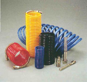

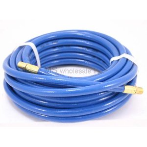

    Are your hoses polyethelyne (thin simi-rigid)Click image for larger version.

ID:	6280 I use PVC air hose with no problems. The clear braided hose that comes with the welders is also PVC.
    Hi Zoama. They are PVC. However, they have got to be the stiffest hoses I've ever used. If it's cold, forget about it! Like I said, I got them on the cheap so, no great loss in giving this a try. Actualy, the one I'm replacing looks like the blue one! In any case, I'll have an extra now.
