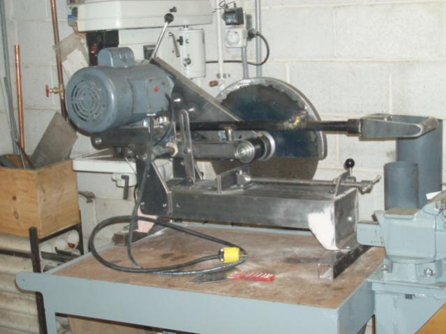

ID:	6289I was looking at saws and decide just going to make one not hard to make and can make adjustable so can set at different speeds for what blade i am using . lots of diy plans on the internet . mostly want it to cut aluminum

    Make one??? A band saw??? Any plans that you found look good??? Got a link??? Thx.
    I am thinking Harbor Freight has some cheap stuff. Would be easier to get one of theirs. I bought a big drill press from them over a decade ago. (when they used to offer free shipping) Still going strong. Just like usual it may not be super high quality but gets the job done.
