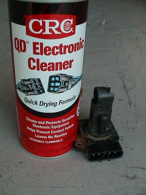

    never blow clean a switch or electrical.. clean with electrical cleaner if dusty use a vacuum cleaner i have one i have one of these . blowing makes condensation in Electrical stuff and pushes dirt in side switchesClick image for larger version.
ID:	6301Click image for larger version.
ID:	6302 its neat little vacuum i use a lot to clean electrical stuff they are not sealed switch's only marine switches are sealed

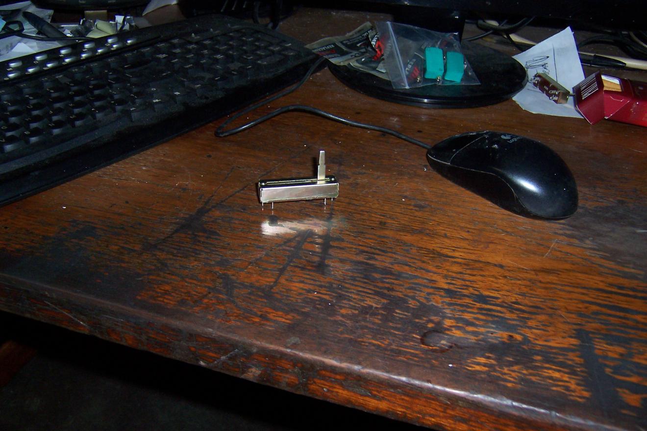

    sorta corny lol but i take a big food storage zip lock bag and put the hole pedal assembly inside bag and zip it as far as it will shut really keeps dirt and dust out of the foot peddle . mostly since from all the metal grinding dust in my shop.. I find the really expensive tig foot pedals are sealed to keep dirt out cheaper ones not sealed that crc is great stuff for dirty electrical stuff . lol i like trying new stuff in my food pedal just got Click image for larger version.
Name:	engine rebuild and installs 007.jpg
ID:	6303 new micro switch and a slide potentiometer i ma going to try
