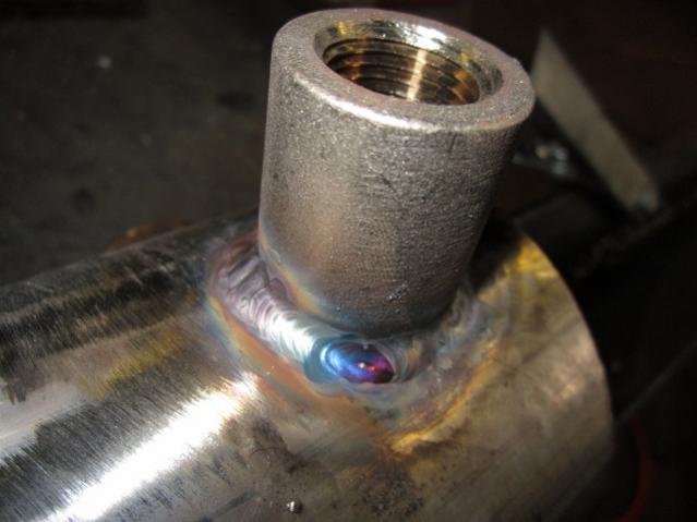

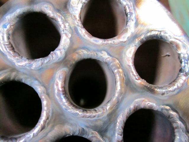

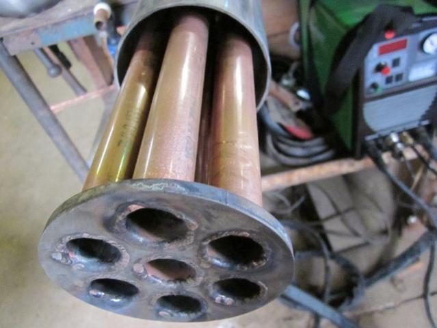

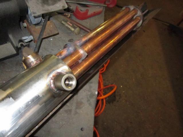

    I'm currently welding up a heat exchanger for a local microdistillery. Everything is welded at around 100-120 amps on my powerultra 205p. Cu to stainless with silicon bronze rods, stainless to stainless with 308 rods, 100% Ar. Pulsing on the copper to ss welds.

    To be clear this is a contract for a LEGAL and LICENSED beverage alcohol distillery. Cu to 304/316 is common all over the industry.

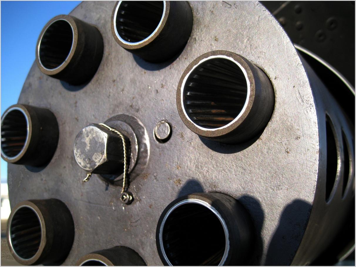

    Looks like a 30mm vulcan Click image for larger version.

    ERCuSi-A - Copper Alloy TIG Welding Rod from arc-zone.com. These can be used for oxy acet brazing as well (I recommend harris black flux) but the results are seriously different. I do work for NOLA rum but this is not for them...
