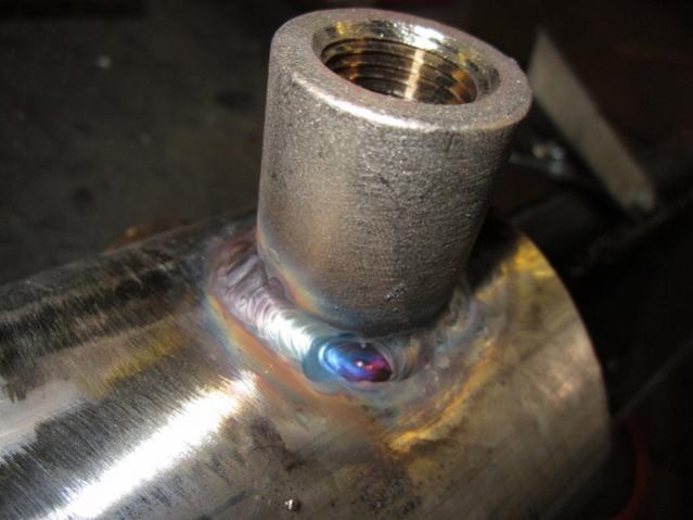

    I'm currently welding up a heat exchanger for a local microdistillery. Everything is welded at around 100-120 amps on my powerultra 205p. Cu to stainless with silicon bronze rods, stainless to stainless with 308 rods, 100% Ar. Pulsing on the copper to ss welds.

    To be clear this is a contract for a LEGAL and LICENSED beverage alcohol distillery. Cu to 304/316 is common all over the industry.

    I've use nickle and other alloys. Copper Silver mix.
    Can you share a little more on the silicon bronze rods. Mix and brand?
    Sometimes I play the plumber and AC man for people. Can you use gas (O/A) with them as well?
