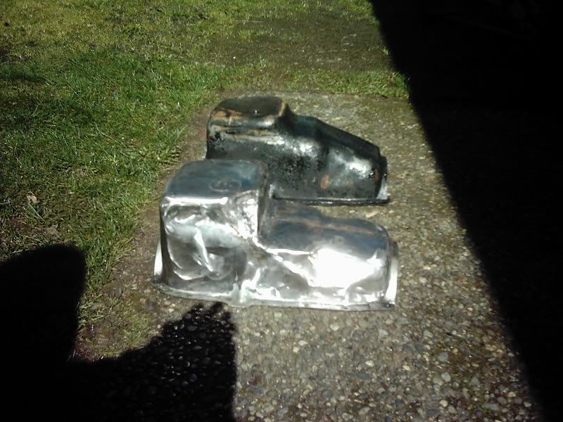

    ...and a couple of pictures of the modified oil pan
    Note the clipped corner of the sump - to clear thr pinion of the front differential

    The oil pan looks smaller and the seams, you do not want one to give up.
    If you mean smaller in capacity, yeah it is a little smaller - about a half a quart or so. The welds are good and solid - chipped on them with a slag hammer and no signs of cracking.
