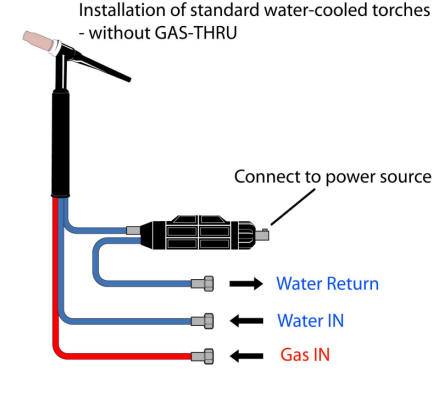

Confirm CK prt numbers for water cooled torch?
I've read a few threads with different info. I'm pretty sure I got it sorted out but just want to make sure. Can somebody look at these parts numbers and tell me if they are correct? Thanks!
CK-225SF FX 250 amp flex haed and super flex cable.
SLWHAT-35 water cooled dinse 35 connector
