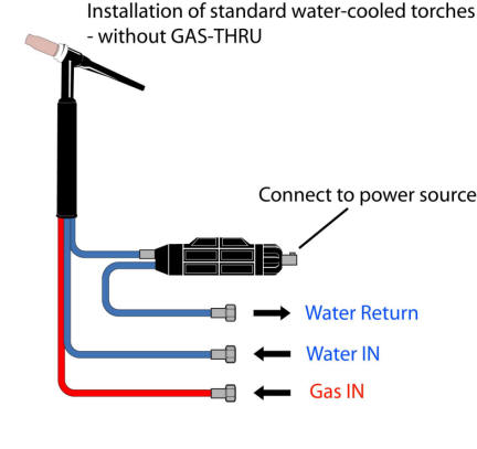

    I've read a few threads with different info. I'm pretty sure I got it sorted out but just want to make sure. Can somebody look at these parts numbers and tell me if they are correct? Thanks!
    CK-225SF FX 250 amp flex haed and super flex cable.
    SLWHAT-35 water cooled dinse 35 connector

    Crap, I forgot about the finger control. I have no idea what to order on that side of things.

    If your using the foot pedal you wont need to worry about the torch trigger. It is just a 2 pin micro switch anyway.
    I'll be doing auto body repair with it for my first project so I'd like to have the finger control.
    I got a quote on those parts listed from my LWS and they were about $250 after tax, seemed a bit higher than I've seen online.
