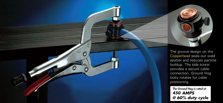

    I made up a Strong Hand "ground hog" for my welders with 25' of #2 cable.. Click image for larger version.
ID:	6604 I'm happy with it so far.

    OK, now *that* is a cool idea! Notice any improvement in your grounding?
    If the stock ground looks like the one in the picture ... it's nice that that there is a stranded copper strand going from one side of the clamp to the other.
  9. #29
    I haven't noticed a difference in grounding, but I never had a problem with the oem ground other than it being too short and wouldn't fit on larger square tube when I close the end for a screw in caster.
    I'm not sure about the second part of your question but there's no strap going to the other side on the ground hog clamp. I stripped the #2 cable back far enough to double it over and pushed it into the ferrule.
  10. #30

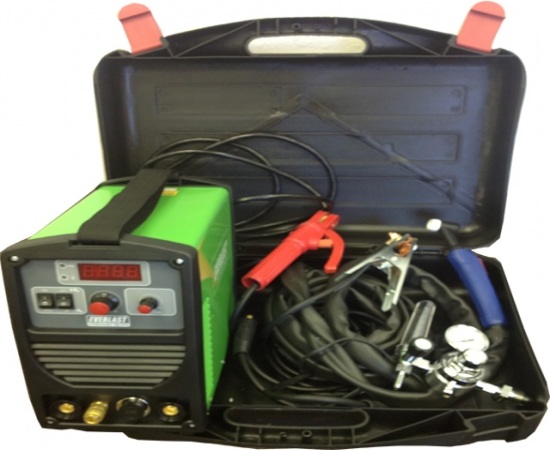

    Sorry. Got lazy. Tried to comment on two people's messages without quoting both. I was talking about the braided strap on the picture of the original ground clamp - here:
  11. #31
    I don't think there's anything wrong at all with the stock ground clamp. It's as good as any I've seen on a stock welder, and better than some.
    A "ground hog" or magnetic flat panel ground is somewhat specialized and specific to the application. If I did that sort of work, I'd just put one together with whatever length of cable needed since it's a QD dinse connector, not a hard connection inside the welder case, as on some welders. S/F....Ken M

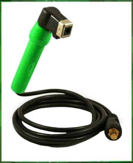

    Hey Rod, is the stick holder on the left the twist type? The pictures for the 140st and 160sth show both and I'm wondering if anyone on the forums can verify which is actually shipped with the unit. I hear the twist types are to be avoided.
    Attachment 6591
    Attachment 6592
    160STH came with a clamp style, which I prefer.
    The above style a number of people like. You have to bend rods to get certain angles (and can chip off some flux make some of the rod unusable) and if you are in a tight spot and have a good stick where you can not rock it, you can over heat the rod and burn the flux on it.
    They are OK
