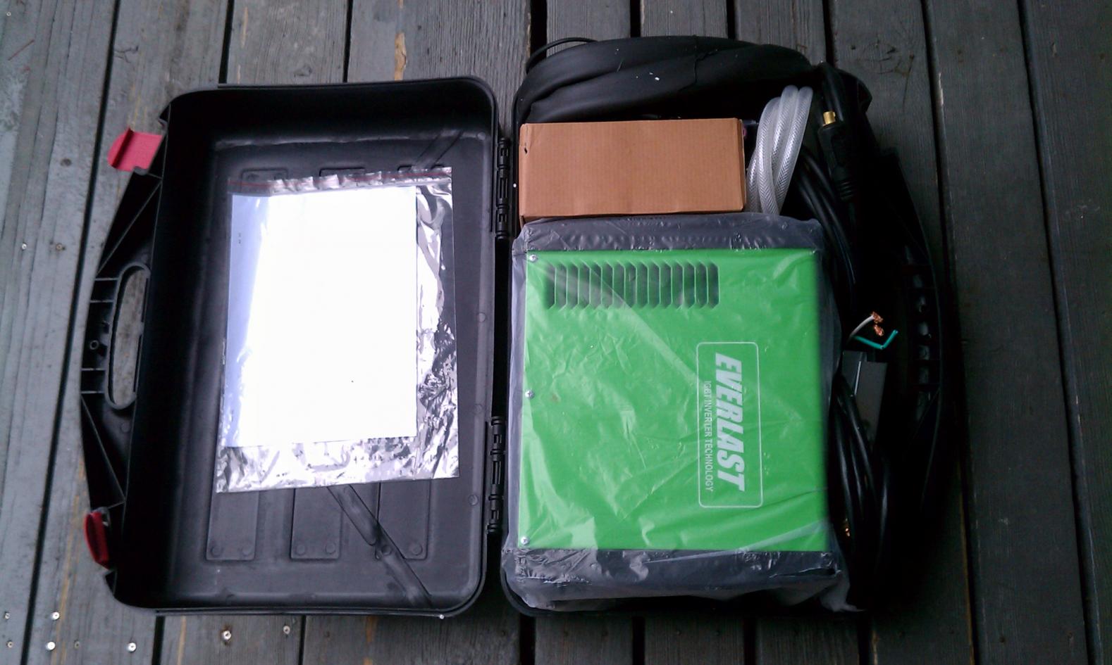

    Well, here is what comes with the 160STH. I just heard they're are under $500. Small and cool.

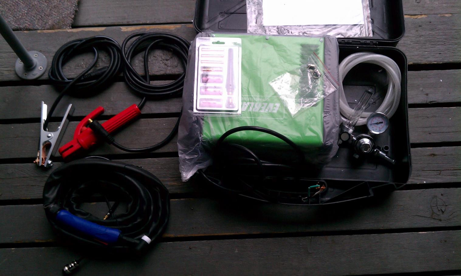

    It has a case, welder, stinger, clamp, WP-17 torch (and cups/collet kit) and a flow meter.
    You just need an AC plug (going 30 amp twist lock for a generator), consumables (filler) and argon tank.
    Opened the top of the small box (small for our products)

    Packed by small hands.

    everything out.

    I was able to put it all back in the case. A portable TIG, stick if the environment is not suitable for gas. Runs on 110volts or generator at 220.
    WP17 might get replaced. Otherwise a nice little package, you are HF start TIG welding for $470 plus a tank.

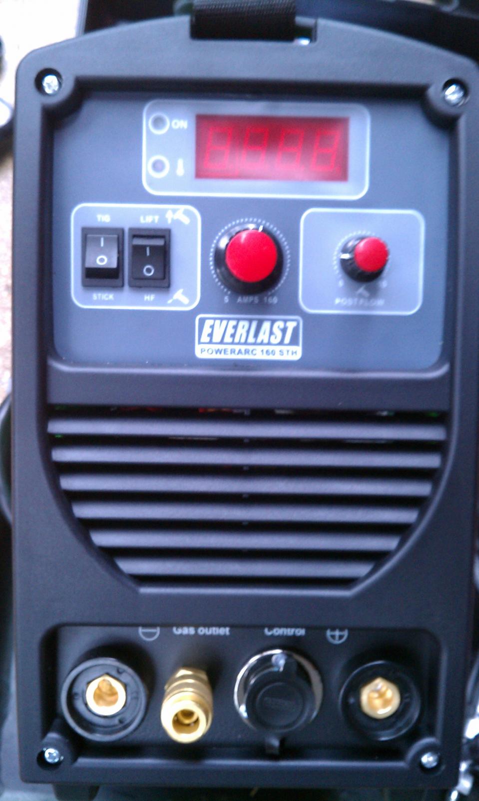

    Has post flow, amps, TIF/stick and HF/lift switch. Really simple and all I would need for thinner steel TIG. The size is the cool part, and I have a couple small tanks of argon so I will throw a 125 in the back of the truck this weekend maybe and go play. Have a diesel inline 6 to an impeller that needs some help. Was gonna MIG it. But might TIG it if the weather is right.
    Front panel. Simple. Purge gas by hand, like I always do, it has post flow, perfect.
    Has a shoulder strap, but I might opt to just carry it and the leads over the case.
    But with the case you can drop in the flow meter, filler, electrodes, tungsten, wrench/screw driver, etc.. OK, keep the case.

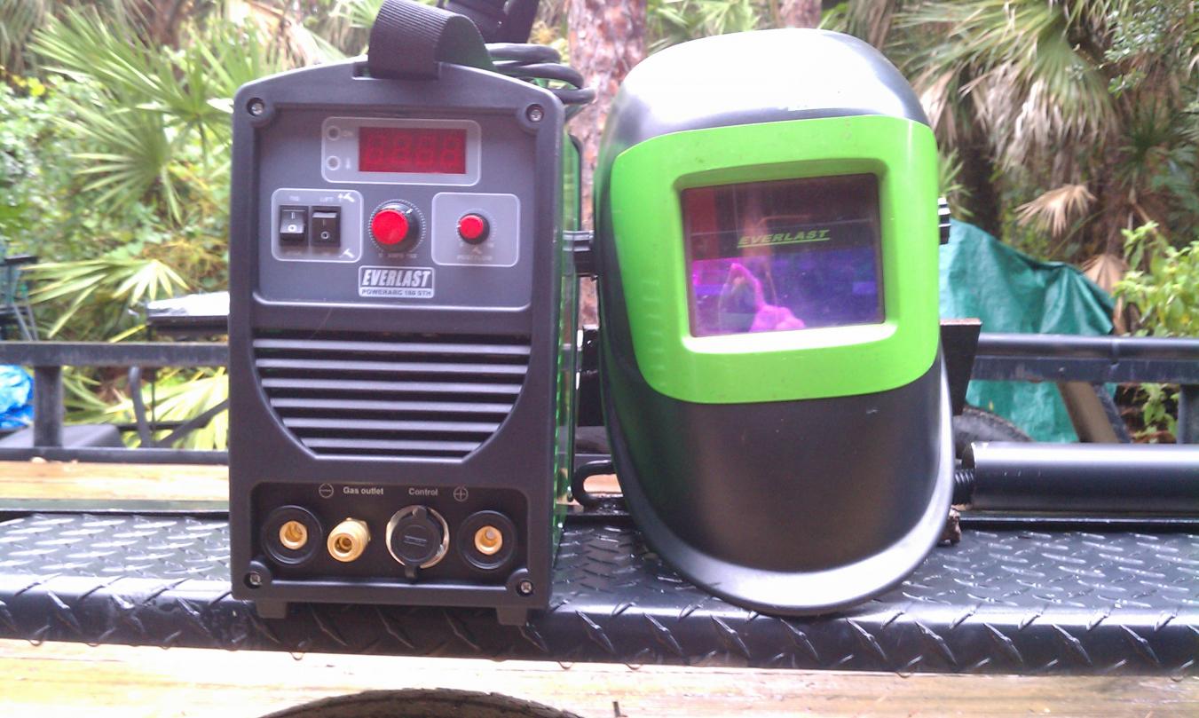

    The TIG-160STH On top of the IMIG 205 and it's above a 250EX
    This thing is small like the 200 and the PA200.

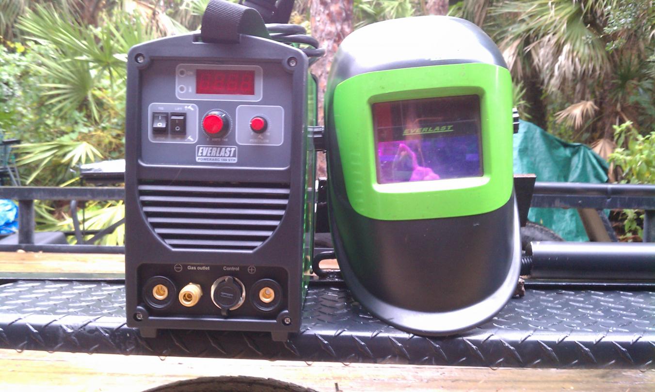

    Actually, to give an idea of the size.
