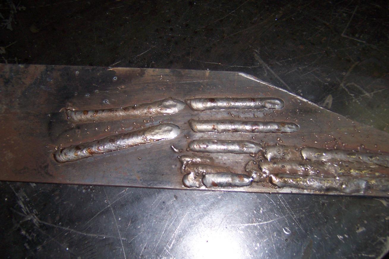

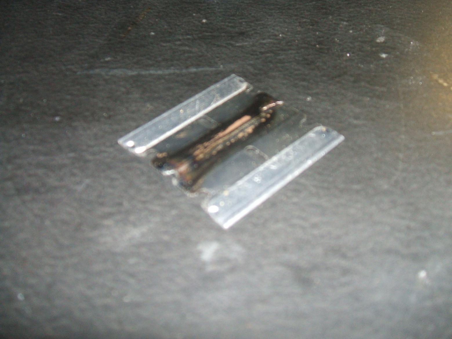

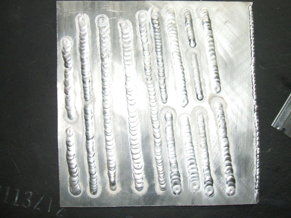

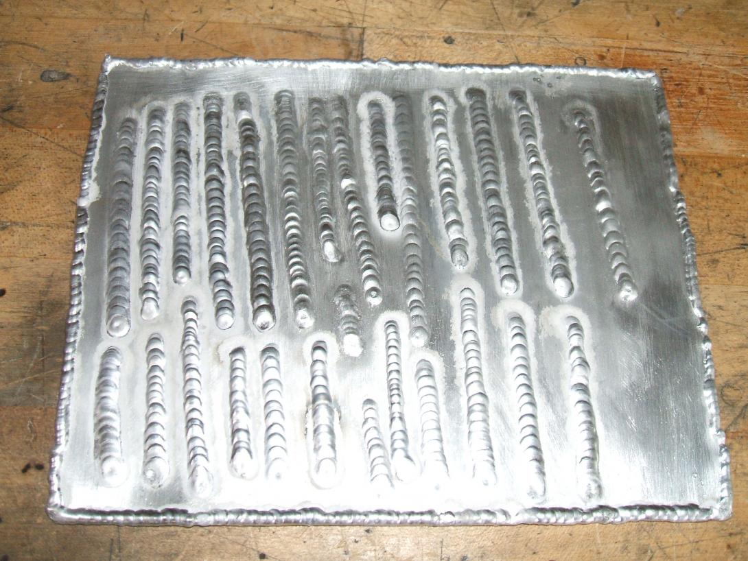

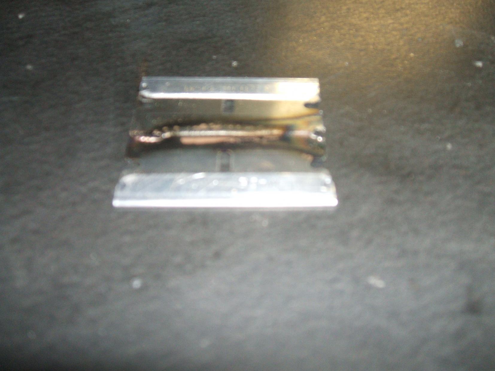

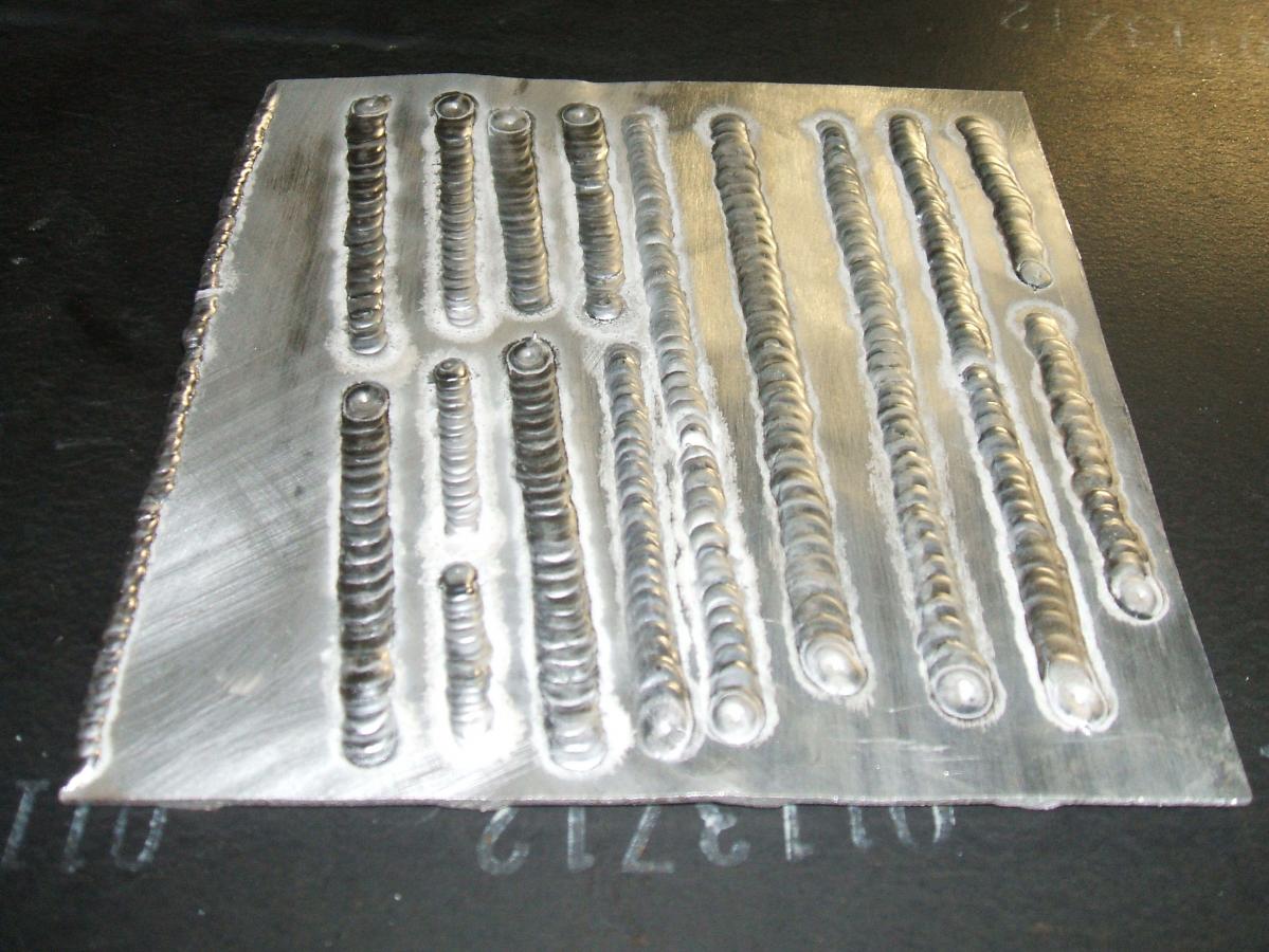

    Hello from Lancaster, PA. Just purchased my first Everlast product, the Everlast PowerTig 225LX, and all I can say is what an excellent machine. Would like to say a special thank you to Alex for the great customer service. I was apprehensive about the machine having a pulse frequency of .5 - 25 pps. but after having a nice talk with Alex and his detailed explanation of pulse frequency and this machine, I felt this was the welder for my needs. I am posting some photos and you can see I was welding beads (using pulse function) right on the edge of .063 aluminum quite easily... now remember, these are my very first beads with this machine and I feel with more seat time, I'm going to get this welder really dialed in. I wanted to show you something right out of the box. Other practice beads were run with, and without pulse. All welding was done with parameters set on machine. Foot pedal was not used.

    welds look good , the more you weld with the welder welding stuff you will get better , took me awhile to get use to a more complex tig but it is nice . I have the everlast 250ex

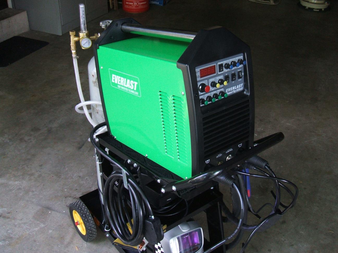

    Yeah...great movie. Haven't seen it in awhile. I think it was released in 1986. "Number 5 is alive!". I see you own a few Everlast machines. There aren't too many welding equipment manufacturers who are offering a 5-year warranty. That was another reason I went green with the TIG purchase.

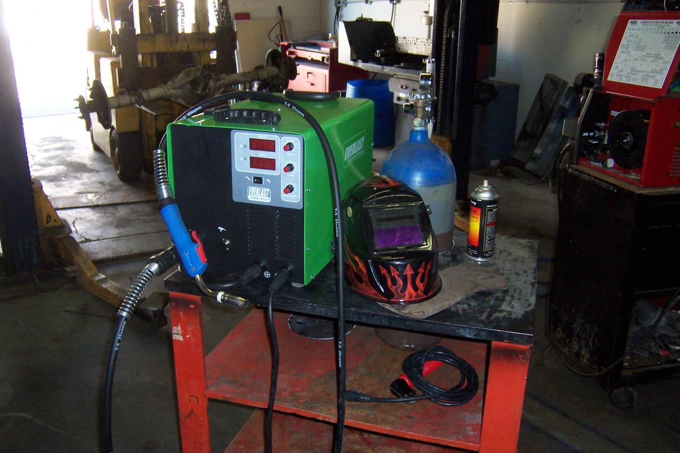

ID:	6366yes had my tig for over 2 years and works great and also plasma cutter , plasma cutter are so nice for cutting just got the mig it sure works nice lol plasma made it nice to cut a round hole for the tank lol that red ugly cart is the base from a old marqet scope

    What is the tank for?
    shielding gas for the mig welder that the i-mig 205 its sorta big unit mostly since it will hold a 44 lb spool

    Welcome to the Everlast forum. Those are nice welds.

    Thank you. I think patience is the key... just take your time and find that steady rhythm. I use 1-2 seconds of pre-flow and wait for the aluminum to puddle. Dip and then move about an 1/8" and repeat. Post-flow I have set to 2 seconds. The beads on the edge... I played around with pulse frequency. Some were done at 1 pulse per second while others I used the max 25 pps. I really wanted to exploit the extremes of this machine to see the effects. I just took the machine out of the box, wired my plug, attached the flow meter, and then went to town. Let me tell you guys, if I can do it, you can too. I'm headed to the garage to get some more seat time... see you later.

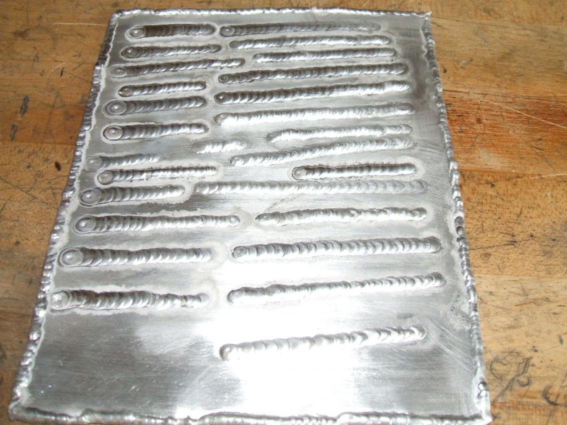

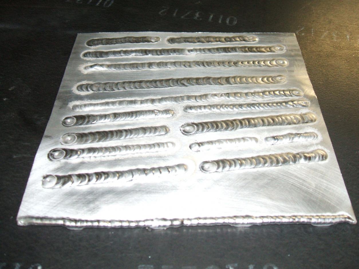

ID:	6442Thanks for the kind words. I really love this machine. Here are some more samples from my second effort. My personal opinion about the 225LX is that it is very forgiving and will do just about anything you want it to. I think it's about time I start creating something. What would be a cool first project?
    looks good do you rest your hand on anything when holding your torch . i have a couple of old welding gloves i kept i roll one up and rest my welding hand on when welding helps keep torch steady for me
    I don't rest my hand on anything other than light pressure on the heel of my hand laying on the welding table. I usually do a dry run or two just to get the feel of direction...then I just start welding. I'll say one thing about this forum, there is a lot of experience and great information available. As a newbie, I greatly appreciate all feedback provided and the overall tone of this forum. It's all about helping each other constructively so we all can become better welders and enjoy this craft. Thank you all...

    Very nice welds! Have fun with your "green machine".
