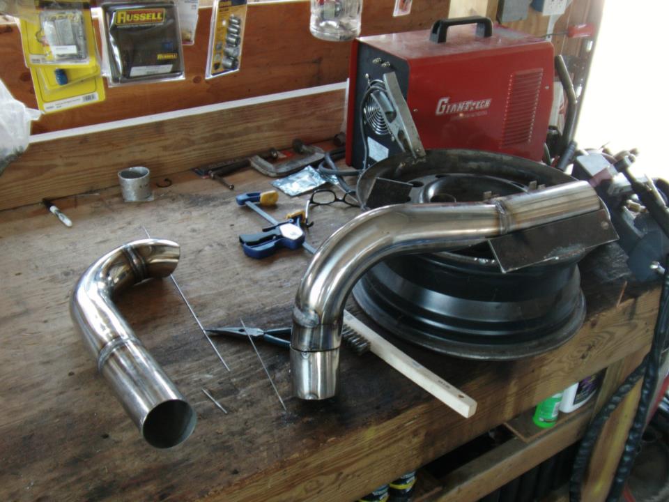

    So before I got my PowerTIG 200dx, I had a GiantCrap 3-in-1 that would only let me scratch start..
    Here are some pictures of the process. I am positive the Everlast will do miles more then the other welder I had!
    Before.

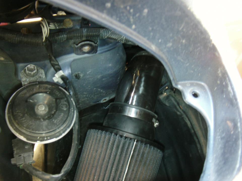

    These are the holes that the air normally came in, crazy restriction!

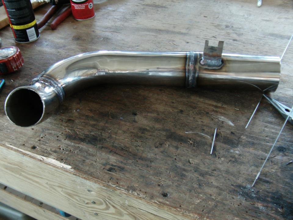

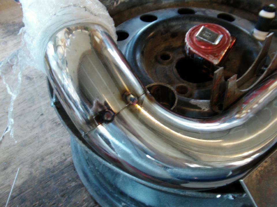

    Then tacking and fabbing.

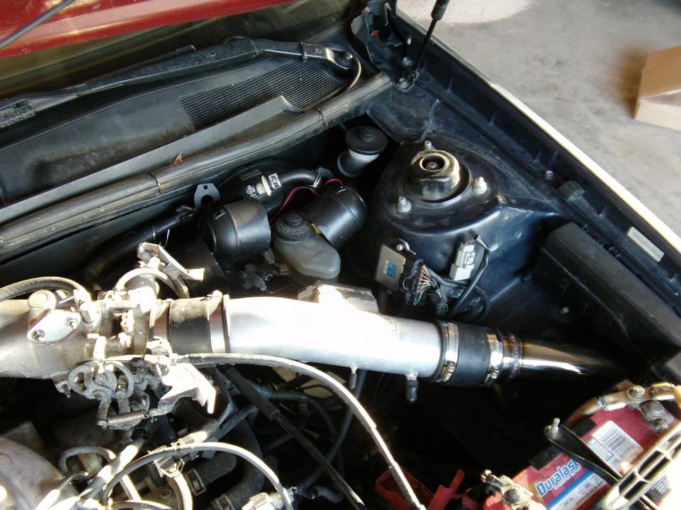

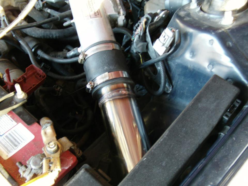

    Then installed.
    AFTER!

    Just out of curiosity: are you fluxing the interior of the joint, or back purging?
    I am backpurging with argon.

    Looks great!
    Just a question: Is that intake shielded or high enough to keep it from taking a big drink of water?
    Yes, we also offer a by-pass valve based on the customers Region as well.
    Spec-C Tuning and Fabrication
    Uh oh, dumb questions alert: this is an air intake, right? Does the expanded size allow rain water in? And how does customer region affect the need for a by-pass?
    Yes, this is an air intake extension off the Injen Short ram pipe.
    I mean, if you drive your car through a puddle that goes up to your headlights, any engine can uptake water!
    Customers in Arizona don't have to worry as much as my customers in Missouri, or New England.
