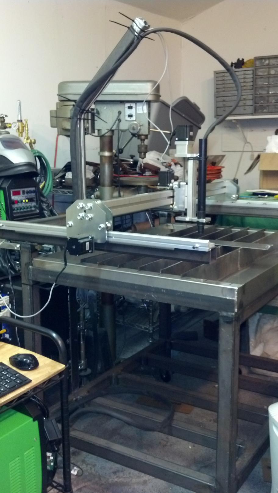

    So, I'm on a tite schedule today, but I wanted to get this thread back in the public eye as I near completion of the project. The whole purpose of this project is to heighten the buying public's awareness of the suitability of the PP60c for CNC plasma table use, which is what it was DESIGNED for. I have encountered SO MUCH resistance along the way, from others, including my hardware suppliers, and I want this table to prove the point that this is a good-no GREAT unit for this purpose. Such was this resistance that the guys I bought the controller and motor setup from said that they would NOT honor any warranty unless I installed a raw arc voltage card inside the machine. Apparently, they had a controller grenade from what I believe was another brand (starts with a L), so they decided unless it was a "biggie" they wouldn't support it unless they actually got a unit in-house to check it out and confirm that the signals are correct for theirselves. The next post will have the pics of how I installed the card. I was able to do so WITHOUT cutting into or soldering ANY of the internal components of the PP60c, so there shouldn't be any trouble there. I'll try to get some pics so you can see where I'm at. I have everything loaded, set, and ready to go, except the 2 wires for the floating torch head. The next step is to fill the table with water, and start making test cuts and get this thing RUNNING! You will notice that the chassis is currently in raw steel. I had the EVERLAST green paint color-matched, and have a gallon of it. As soon as I get EVERYTHING completely turnkey, I will disassemble the unit, sandblast it, and paint it to match! More later.

    Default INSTALLING A RAW ARC VOLTAGE CARD IN THE PP60c
    HI! Due to the time it takes to generate these posts (I'm a slow typer, but like to get the wording right so folks can understand) This will be broken down into multiple posts. Maybe I should get that Dragon voice recognition software-If anyone uses it, please speak up, I need to know if it's worth it. Anyway, The RAV card comes mounted to a plastic base, great idea as it protects it and makes for an easy install.
    The instructions for the card say to mount it at least 2 inches from any other electronic components insidse the machine. On the PP60c, all I had to do is make a little mounting bracket, and I was in business. Good luck on others, I have no idea what the inside of any other plasma cutter looks like. So, I made the bracket out of a piece of 1/8" aluminum (DARN, no welding needed!)
    Sawed it with my 12 volt Milwaukee Hackzall, Bent a 90 at one end, drilled clearance and mounting holes for the card, then mounted the assembly on the front panel of the machine, using that 3M mounting tape. I was going to epoxy the bracket in place, than I thought, Airplane companies are using this stuff to fasten skins to wings these days, so I'm confident it's up to the task.
    Below are some shots of the card in place from a top and bottom view.
    You will notice in the bottom view, the wires are already hooked up, next post will show the rest of the install. Please bear with me on these images, as I use photobucket, and they are messing around with it, so I have some tweaking to do to ensure I don't have postage stamp sized images followed by poster size.

    Default Raw arc voltage card install part 2
    Since I actually have a decent connection, I'll keep going til I run out of time. Below is a shot of the whole unit, right before I replaced the covers.
    Before I hooked up the wires, I drilled a hole in the back of the cabinet, and installed a rubber grommet, for a finished look.
    Before drilling this hole, I used tape and plastic to TOTALLY isolate the area and prevent ANY metal shavings form getting near the innards of the machine. Keep in mind that one tiny shaving getting on a board could cause a short and a blown machine, so extra extra care MUST be taken for this operation, I can't stress this enough!!!!
    Rather than risk tapping into any wires, what I did was used my ohmmeter to locate the proper wires from the CNC port for torch on/off and arc ok, and used the EVERLAST supplied plug to run those wires back into the machine and to the RAV card.
    The 2 black and 2 green wires in the pic of the card in the last post are those wires. By FAR, the SAFEST way to hook into the card. I made 20 gauge wires with proper connectors to tap directly into the ground and torch output where they attach to the front panel, and ran them to the RAV card, as instructed, then ran the 2 cables supplied with the card from the RAV card, through the new hole in the back, and to the THC module.
    One of the cables is a flat, 4 conductor cable, the other is a round, black cable like a stereo headphone style jack. The 4 conductor is for on/off, and arc OK. Next to it is the Digital Current Probe, which is also plugged into this box. Below is a poor (sorry) pic of the controller mounted directly to the plasma table. The yellow CAT5 cable is the only wiring that links the controller to the plasma cutter.
    From the controller, there are 2 cables that link up to the serial and parallel ports on the computer. And that's where I have to stop for now. I have a few hundred things on my to-do list. More later. Feel free to ask questions or leave comments, Feedback is good!
