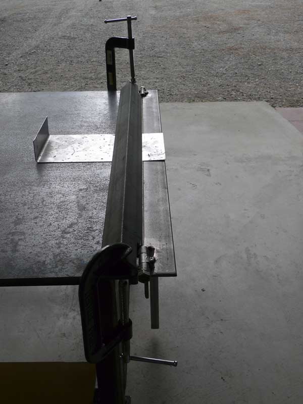

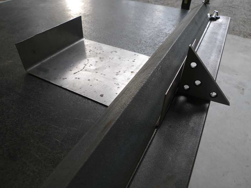

    You notice, I added a light duty sheet metal brake to the long side, 36”, made of 2”x1/4” angle. Made hinges from tube, and using ½” bolts. 1” square tube handle, with adjusting stop for leveling of the brake with table top. I can use an angle to check bending angle that way. The method of holding down the 2”x1/4” brake die is so-so, but for now it works.
    The 2”x1/4” angle brake die edge which meets the metal was flattened with an angle grinder to give a sharper bend radius. The metal in these pictures is 18gauge, about .047”.

    The brake doesn't get in the way, has a solid support, and comes in handy when I need it. I've used it with up to 16 gauge steel with no problems so far.
    ken
    I was trying to figure out how the brake worked, now I see you use the angle clamped down to hold the sheet metal. Smart. Table just the right size to wheel around as needed.
