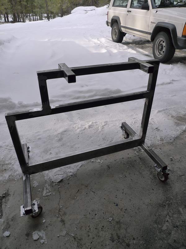

    The Harbor Freight 4X6 Horizontal/Vertical Band Saw comes with a stand that is too low, and in my opinion, not built strong enough for the heavy saw it is supporting. I turned the original stand into a smallish storage shelf, and built a new stand.
    Dimensions:
    Length: 35”
    Height: 29”
    Width: 22”
    Step cutout for motor clearance: 8” deep
    Materials:
    1-1/2”x1/8” square tube
    1-1/2”x3”x1/8” rectangular tube
    3” swivel locking casters

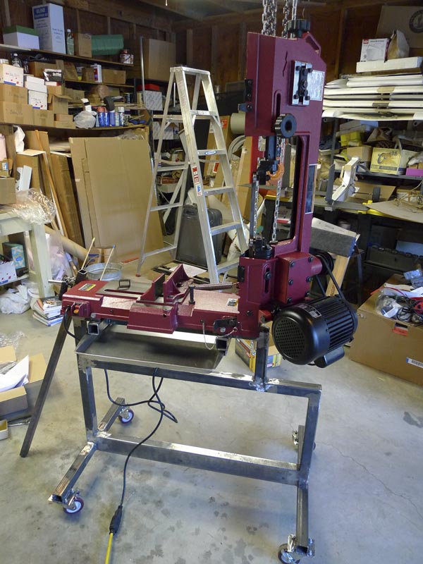

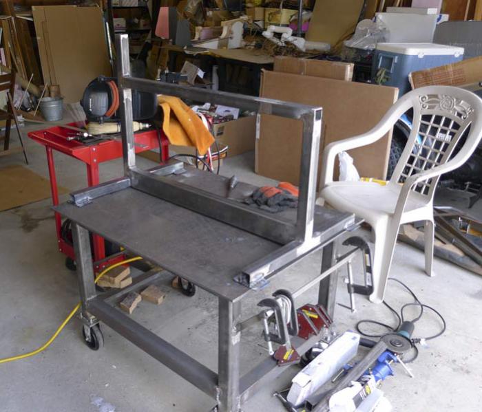

    I welded the stand with stick. Four short sections of 1-1/2”x1/8” square tube were welded like wings to support the saw. A space was made for the motor when positioned vertically, allowing the saw to be forward on the stand, for better center of gravity.

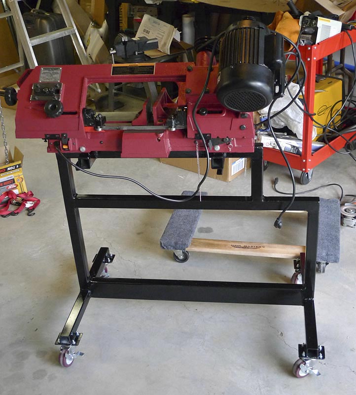

    Six tabs made from 1”x1/8” angle were cut as standoff mounts for the saw. Two on each side, and one each front and back. I drilled these for the mounting bolts, and bolted them with enough slack that they could be moved by hand. I hoisted the saw on a strap and positioned the tabs where I wanted them. I tacked the tabs, and removed the saw, so I could finish the welds. I finished the stand in gloss Rustoleum Black, for easier cleanup. (the square tube leaning on the saw is not part of the stand, but some stock I was going to use for my first cut test).
    I tacked two short pieces of 1" angle, to the underside of the saw mount 'wings', to accept a large cookie sheet for saw swarf collection.

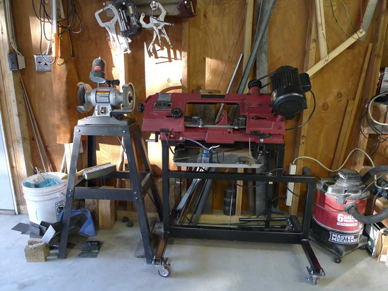

    The four casters are great. I can move the saw anywhere and slide it into any corner. I never use the caster locks, the stand is stabile on its own.

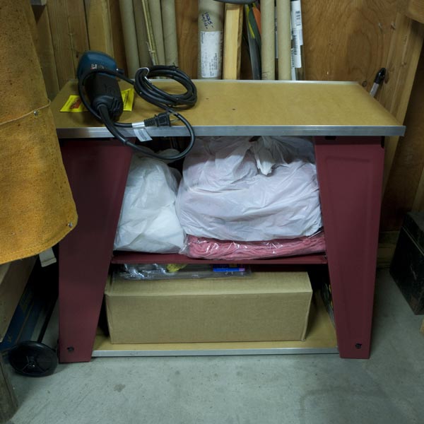

    The original stand is now a shelf. Notice the spindly plastic wheels that came with the saw.
