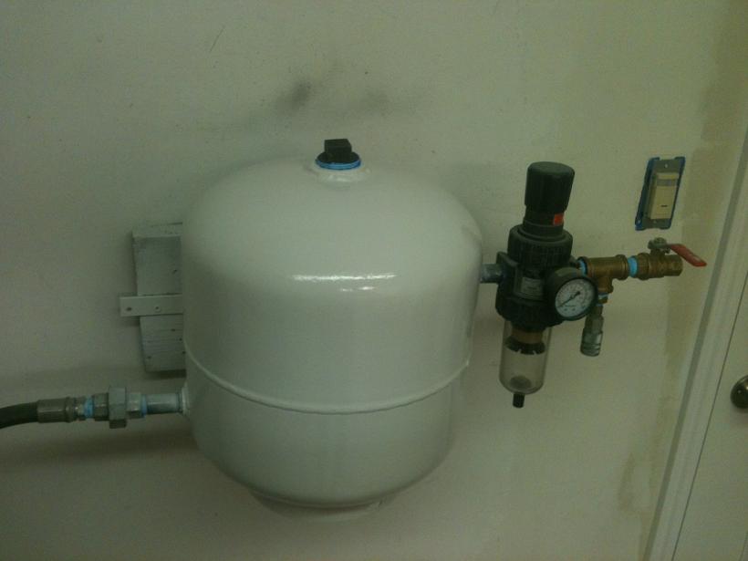

ID:	6925 home made filter dryer Click image for larger version.
    How do you change the desiccant in your home made dryer, Rod?
    has a bung plug on top to fill and a bung plug on bottom to drain litter use a piece of stainless steel welding rod to knock the stuff loose to fall out of bottom plug hole. oh this is not my dryer i am making one but using a different container so easier to change dissnent . was going to use water filter housing since easy to open and dump stuff and refill and there rated a 150 psi http://www.ebay.com/itm/10-whole-Hou...item35a33cdf15
    Couldn't see the plug on the bottom and couldn't imagine you taking it off the wall and shaking it upside down to get everything out! LOL
