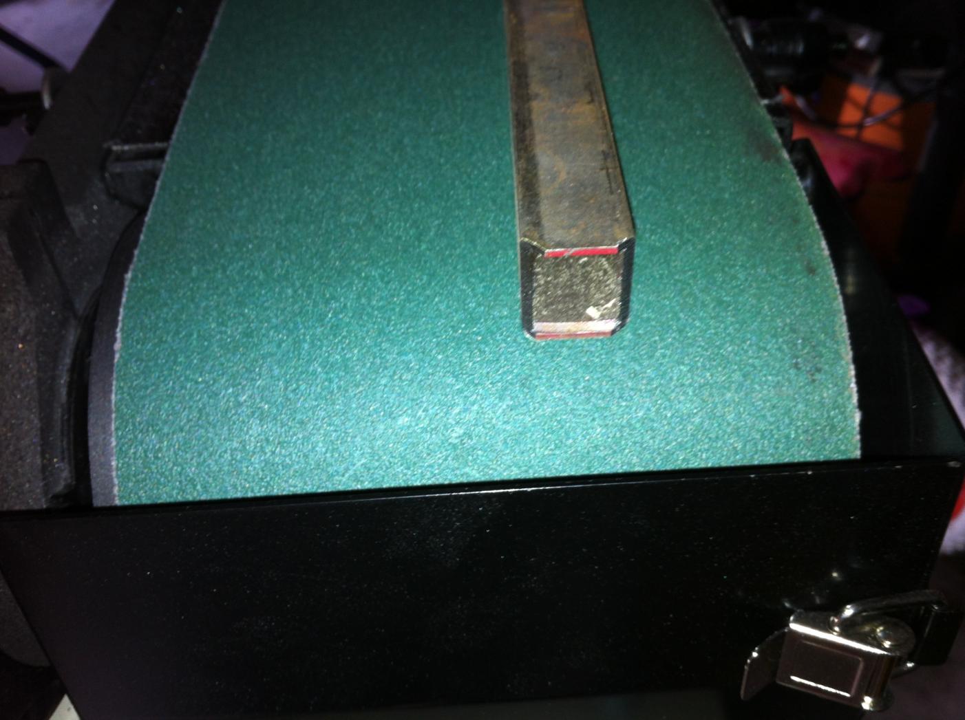

    So, I tracked down the right size of zircon sanding belt and bought several 60 grit belts. I just got around to trying them out after they sat around on the floor of my office for about a month .
    Seems to work pretty well on steel, but you definitely don't want to try and remove a lot of material ... truing up the angle should work pretty well though.
    Not that I want to start another "how to grind tungsten thread", but I did sharpen about 30 tungsten on one of the belts that I've dedicated to the purpose. This worked really well, and it's a nice wide, flat surface to work on. I chuck the tungsten in my drill and spin it on the horizontal belt. This also has the advantage of having the belt moving away from the tungsten tip, so there's no chance of flinging the tungsten across the room. Does anyone know if zircon media will contaminate the tungsten, like AlOxide would?
    Thanks
    Mike
    Power Pro 256
    There would be a little contamination, but just like aluminum oxide, these are just fine particles left in the scratches, they will blow off as soon as you light up. So just light up on a piece of scrap or a copper bar, after you sharpen, to flash off anything on the tungsten, and you're good to go.
