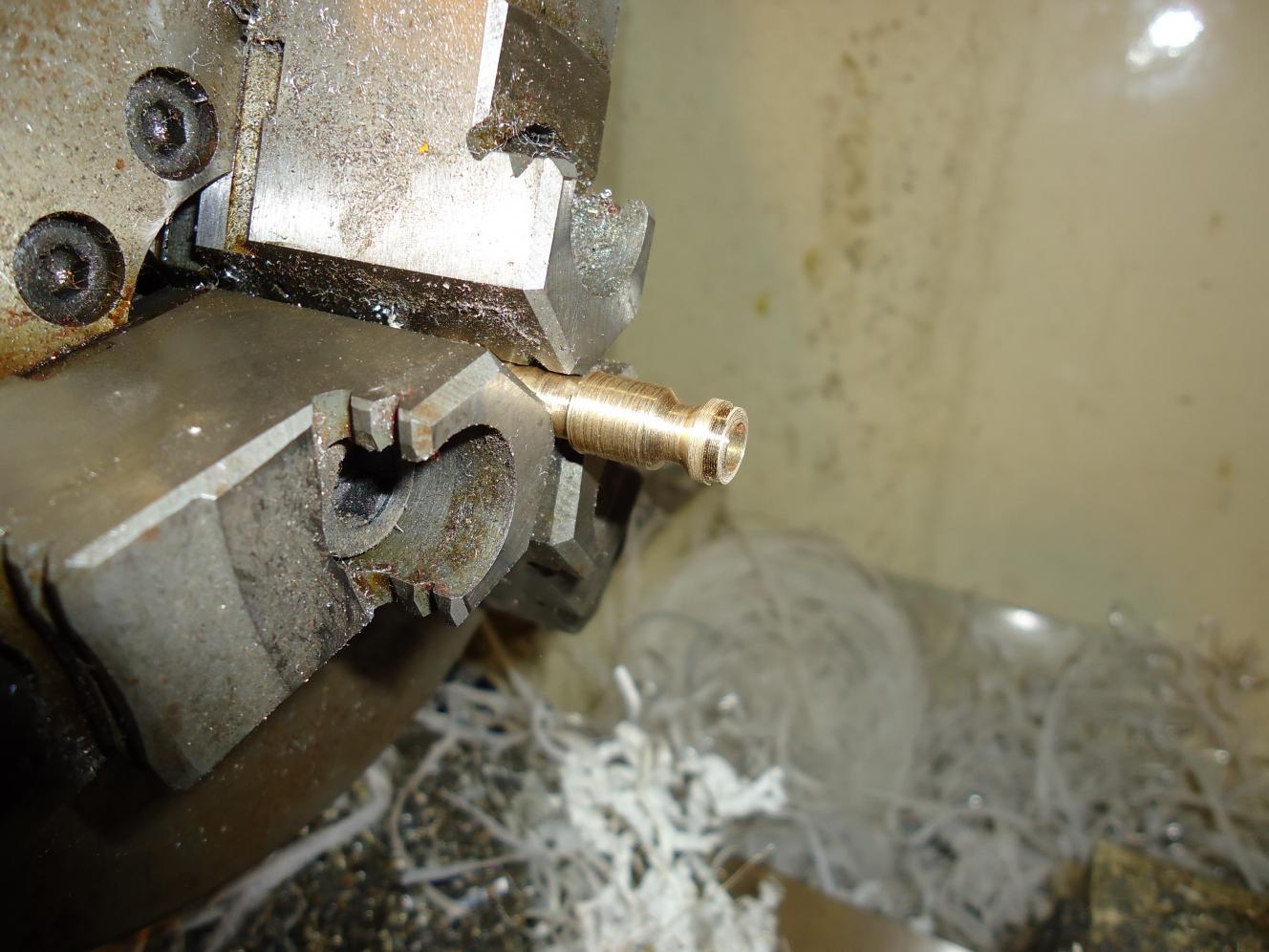

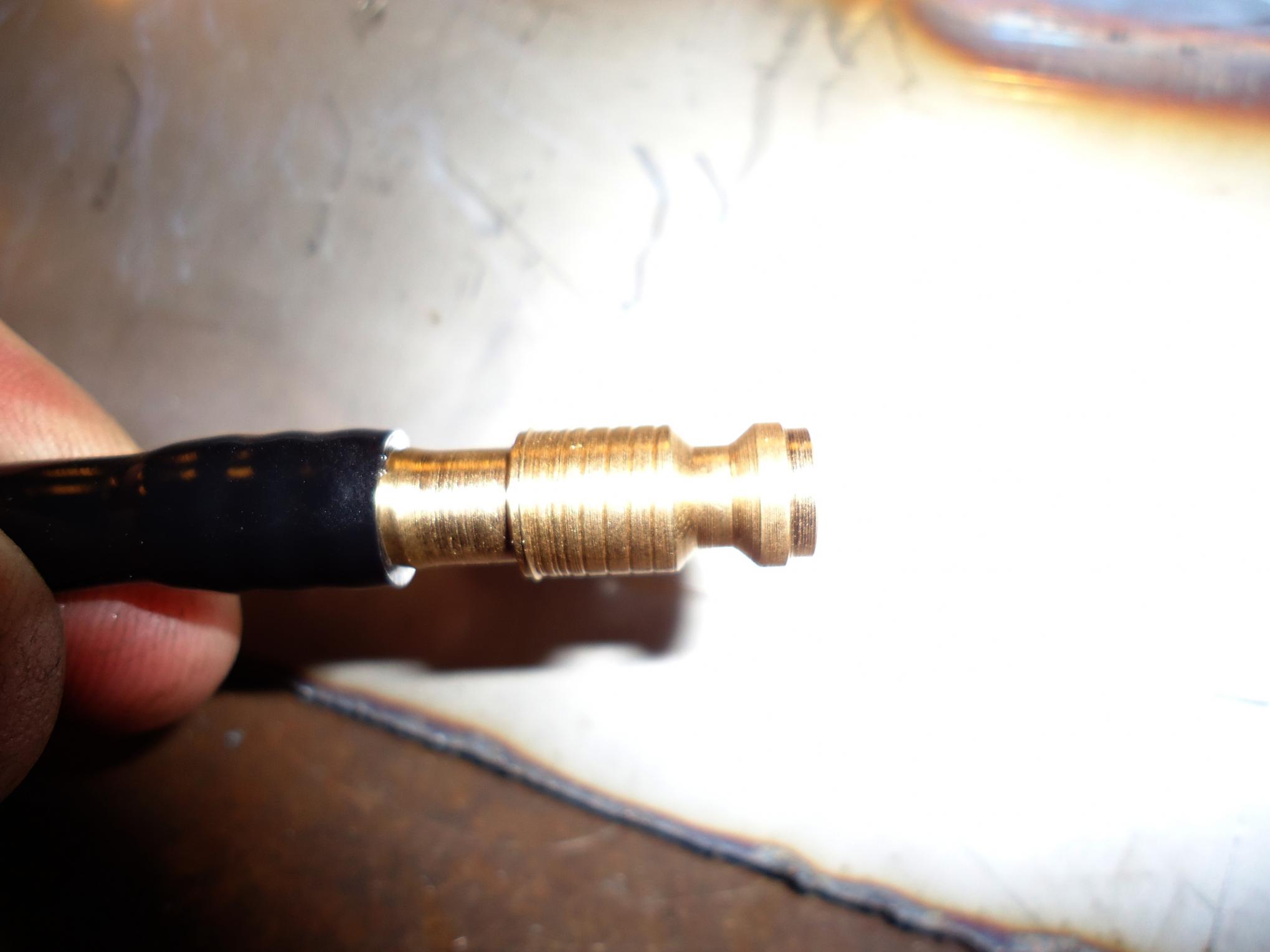

    That's what i did ,after a trip to the city driving around today too 2 welding supply shops not having any fittings, i got to looking in the air fittings bin and a standard brass air fitting is just a little bit larger.I figured what the heck $10.00 and 2 weeks shipping time to get it. I just as well spend some time and make one.Took about 15 minutes on the lathe works fine no leaks.Click image for larger version.

    cbmkr nice work, I think Rambozo suggested doing this. I ordered some fittings and hope they are the correct ones, I will verify later tonight. Everlast has them but the shipping kills me almost 2x the cost of the part. I emailed Sjon from CK Worldwide and they have the fittings part #1006 (ferrule) and #2564 (male plug) people just have to order through their CK dealer.
