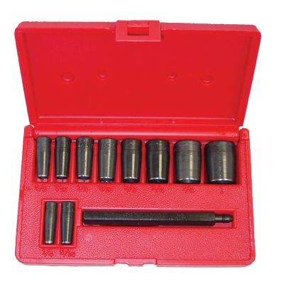

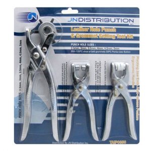

    could use a grommet hole punch Click image for larger version.
ID:	7092 I have a matco gasketClick image for larger version.
ID:	7093 making set it would work good
    As he described it to me, its a machined steel block with a round steel form. You place the brass disc in the block, sit the form on the top and smack it with a hammer. It forms the "cup" and trims off the excess material. These screens are pretty sturdy. I'm not sure one of those punches could make its way through the material these particular screens are made from.

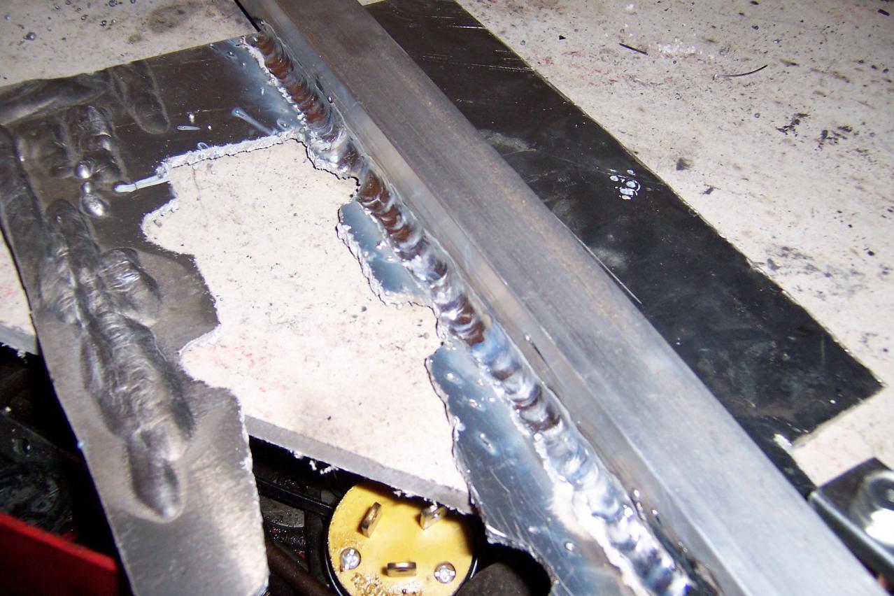

    have to try that with my mig spool gun a diffuser would really help welding aluminum tried my new everlast spool gun today . only had a rolls of 5356 wire have to get some 4043 since welds nicer . took a pic have to get use to not having a speed control on gun like my last one i had .Click image for larger version.
ID:	7155 not bad since i did not clean the aluminum before welding it plus is only 1/8 aluminum
