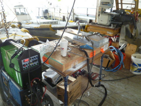

    i do a variety of work. recently was asked to install these windows in an older retired naval vessel that is used at an area port.
    take note of my field plasma cutter for cutting the radii.

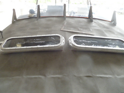

  2. Default windows
    windows/ install and weld

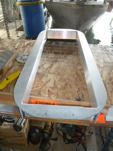

  3. Default windows
    install and weld. welded out with xmt 350 inverter and 30 spool gun using .035 wire. skin was only .10 thk, angle frame to seat windows on was 2 x 3 .25.
    i am nearly always out in the field.
