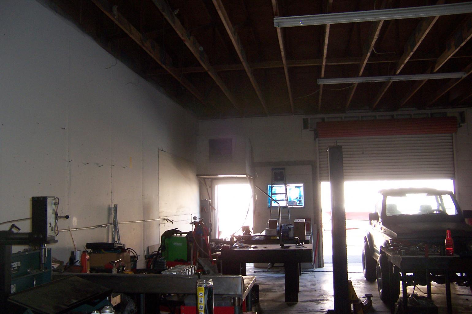

    I run .035 since all most everything i weld is 1/4 or larger , since have my lincoln with .023 for thin stuff
ID:	7109its the 2 big swamp coolers running lol big boys 8500 cfm coolers should of saw me getting that big cooler over my door way lol

    Too funny. I see where the draft is coming from there. I have the same setup but smaller.
