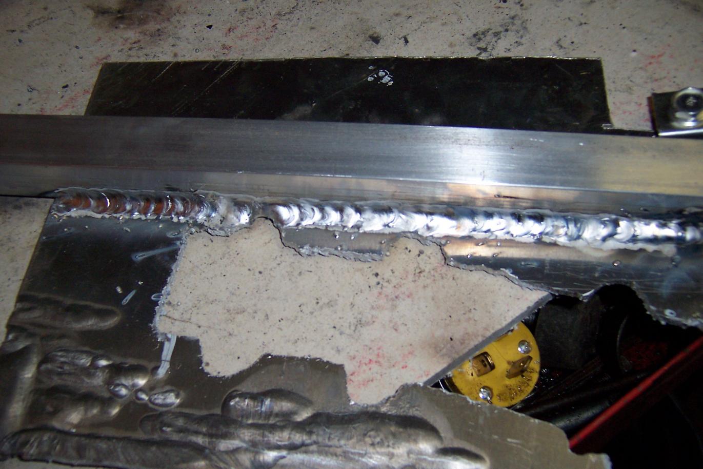

    well got some time to use the spoolgun for the first time . a little touchy since have to control speed at welder not like my other spoolgun were you controlled wire feed at gun but making a box to so can adjust feed not at welder later . here some pic also really thin stuff ususlay not welded with a spool gun , gun fed wire very smoothly and has a nice feel when working with and made very well heavyClick image for larger version.

ID:	7151 duty also this aluminum is dirty didn't clean before welding
    Curious as to the wire size and type you used as well as pushing or pulling the puddle,,,from what I gather ,,on a machine 200 amps and under the max wire size should be .035 or smaller and the wire type should be a softer wire like 4043 not an alloy like 5356,,,at least that what lincoln says in their article on migging aluminum

    this spool was some .035 5356 i had laying around at my shop , 4043 welds nice with spool gun since has silicon mixed with the aluminum . .030 welds nice on thin stuff . this was at about 21 volts and 110 amps when i welded this this stuff , 4043 take less amps since softer and lower melt point would be like 80 to 90 amps with .030 4043 wire the wire i used was lincoln super glaze. I had a spool gun before this one and liked the Forney 42296 MIG Wire 4043 .035 Aluminum was the best out of all the aluminum wire i used. oh i do ac repair at my shop and do my own ac hose i use weld on barb fitting , do it gas welding use these guys welding rod its really easy to use http://www.muggyweld.com/?view=aluminum
