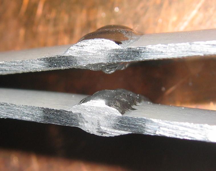

    Just wondering....
    Most people say that you need a build up of weld material approximately the same thickness as the material your welding.
    If you get full penatration through the material your welding is this still the rule?
    I know you can weld then grind off the welds to look good, which I do a lot, but is the strength still there if you get full penatration with the weld?

    It all depends on the joint and how you prep it. If it's a butt joint, you can vee both sides to 37 degrees and leave a proper gap between the plates, then fill that with weld back to the top and the joint will be as strong as the filler metal you use. Other joints will require a fillet to be full strength.
    The thickness of the weld, or the "fusion zone" (the metal that has been melted and resolidified, to form the weld) would indeed include both the portion beneath the surface (also known as the "depth of fusion", but more commonly referred to as simply "penetration") as well as the face reinforcement (the part of the weld that rises above the front surface.) Sometimes, the fusion zone can even be "sunken" below the back surface as well, and that counts too.
    Assuming your filler rod is the same or greater tensile strength as your parent metals, there is little advantage to thickening the fusion zone by much more than the thickness of the parent metals. Unless you need something like increased ridigity, etc. But to allow for a little porisity, contamination, or other discontinuity, building the weld a little thicker (like say, 120% of the thickness of the parent metals) is not a bad idea, IMO. Failure right down the middle of a weld is not a good scenario, and is also often avoidable with more thoughtful welding technique.
    The above assumption may also not be true. Often times, (such as with many aluminum alloys) the parent metal will weaken in the heat affected zone (if it's been work-hardened and/or heat treated, which is the case for many metals.) Depositing a thicker weld won't repair the loss of tensile strength the parent metal will encounter that is next to the weld.
    Penetrating fully is better for fatigue resistance, and avoiding a stress riser that can occur in a root that is not fully penetrated when put in tension.
    There's a lot that goes into weld joint design, these rules of thumbs assume many things. But the post would be too long to cover all aspects of weld joint design. There are books that discuss recommended dimensions of some more common weld joints, which would serve as a good starting point for destructive testing on welded sample coupons.

    Cutting a section, followed by polishing and chemical etching (typically using specific acids applied for specific lenths of time) can reveal the depth of the heat affected zone in the parent metals - as well as the extent of the fusion zone. Sometimes these different areas can even be visible to the naked eye without doing any etching:
