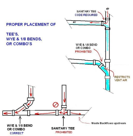

    There seem to be a few other likely issues with that plumbing shown in the pictures as well. I see what looks like three sanitary tees being used on their backs, which is a "no-no". This graphic explains the most commonly performed correct - and incorrect - usage of sanitary tees and wyes:

    Also, there's no evidence of any primer (purple looking stuff) being used on the PVC solvent weld joints. Sometimes that's required to be used. Often times new drain work will be pressure tested as part of the inspection. (All good reasons to route the condensate into an existing trap!) Routing the condensate into a flower bed would have been a good idea... until winter hit and it freezes solid.

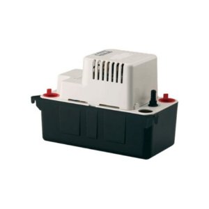

    There condensate pumps designed for pumping condensate up a floor or two, if needed. I always think it's best to have gravity do the work whenever possible, though.
