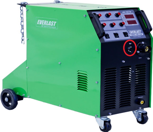

    The 250p does have a spool gun connection but I've never used it. Click image for larger version.

    The 250P in Canada do not have it spool gun is a Options as in their flyer. (spool gun ready NO) all the others have them (spool gun ready YES)
    Canada, doesn't seem to be carrying the models actively in Canada. Not sure why, but that's why they have not updated it. Definitely have fielded quite a few inquiries from up there on the unit.It probably doesn't fit their marketing tactic. We can sell direct in this case. But the 250P's have been relatively trouble free, and it is a good welder.

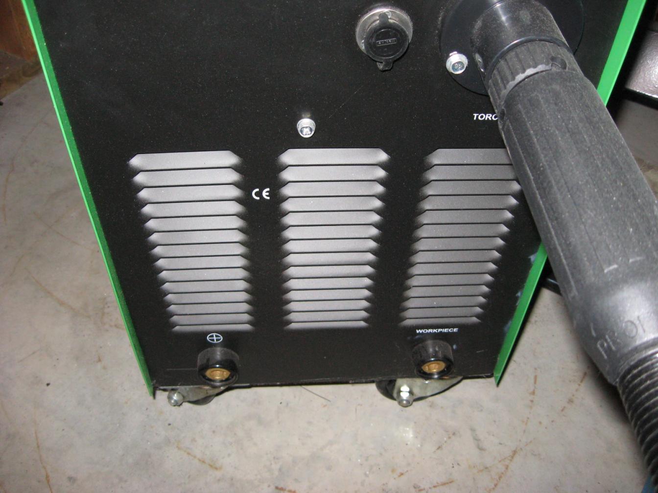

    Ok, that picture brings up another question, how exactly do you switch from DCEP to DCEN?
    I have never seen a Mig machine that switchs - DCEN to + DCEP unless it is a stick SMAW also and then they have Plus + and Neg.- out lets.
    Although not in the first pic I posted, there's a positive and negative dinse connector at the bottom for stick welding. You just connect your leads to the appropriate ones. Click image for larger version.
    I've never seen one that doesn't!

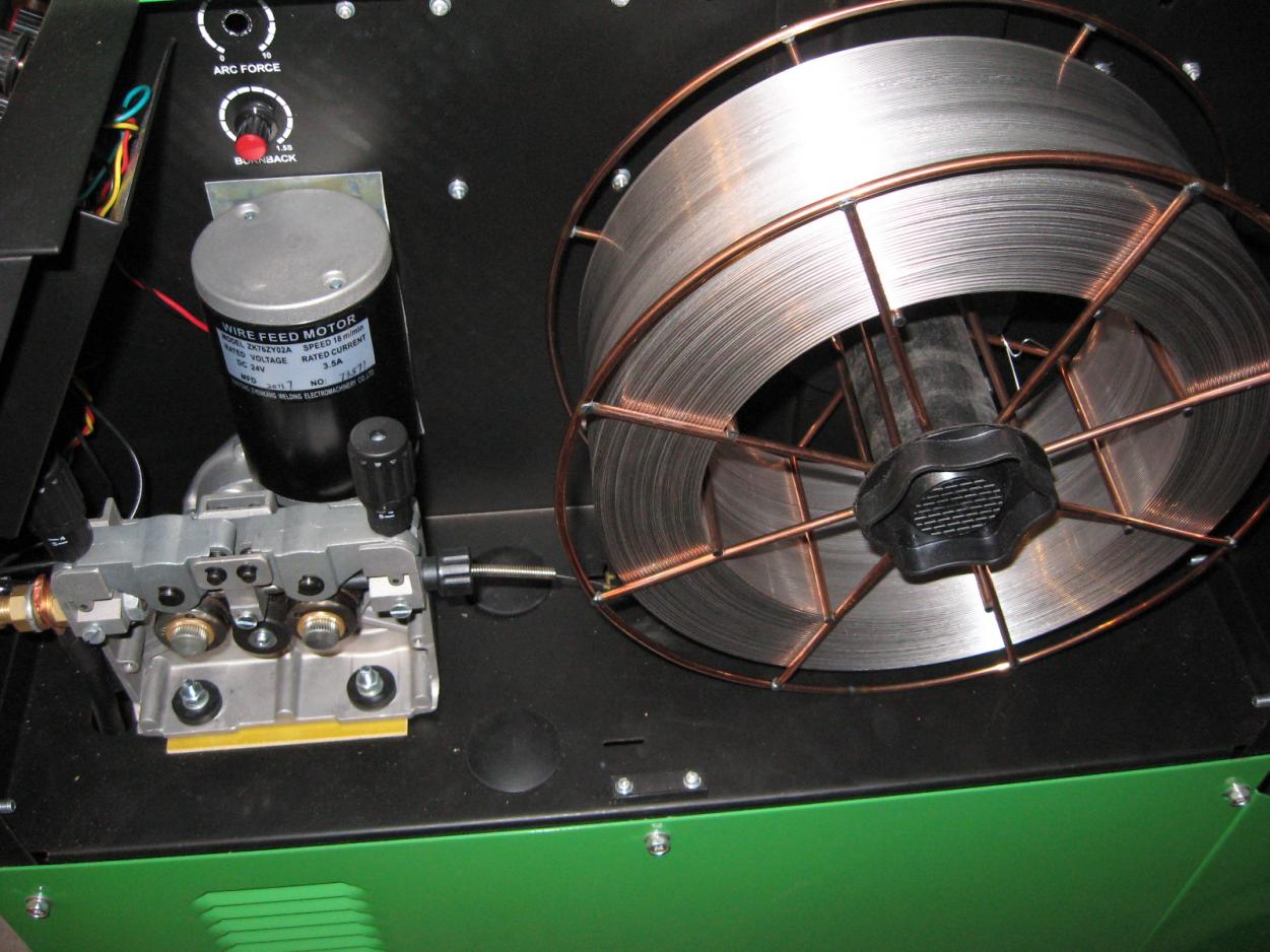

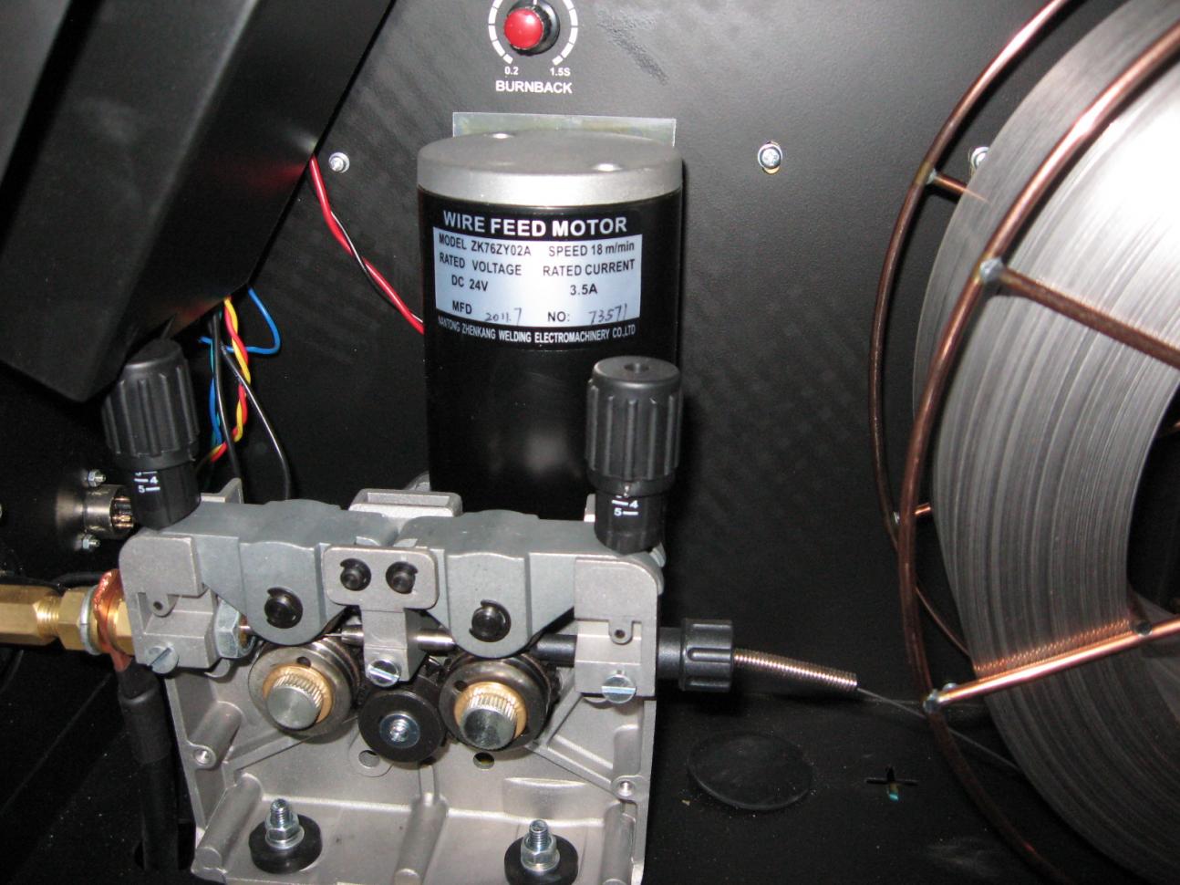

    Most machines have some way to swap polarity as some wires (flux core for one) require DCEN instead of standard DCEP. The online manual for this machine really isn't, it's for the iMIG 200, so there is no description for this machine. Typically there is a terminal block near the drive rollers with jumpers that will let you swap polarity. I'm sure Mike or Mark can provide the details, maybe even a photo.
    Yep, that's how you swap it for mig.
    Edit: I spoke too soon. I don't see a way to swap polarity inside the cover. Click image for larger version.
