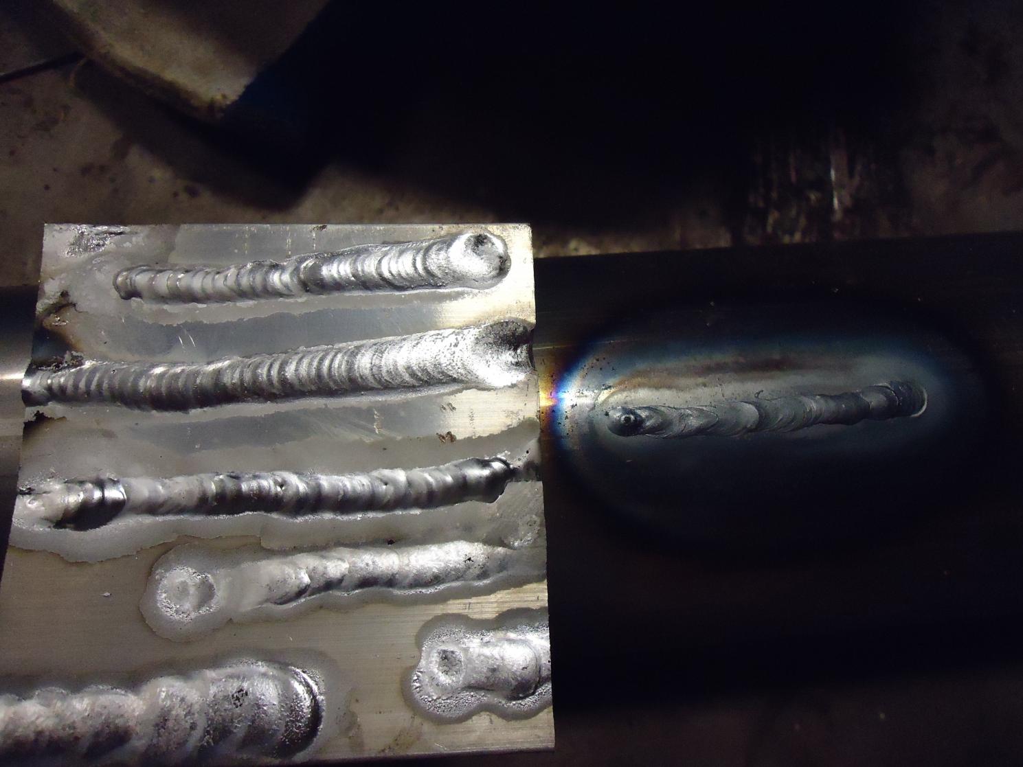

    Have had a little time to play with the second machine ,I have worked around the one small issue for now,I tried the machine on some 1/8" aluminum and some 095 mild steel tube. I used 1/16" dia ( 3/32" would do better) rod for the Aluminum and steel, I tried 4 different amp settings on the alum settled in around 70-75 seemed best no pedal torch only.Ran the steel tube at 70 amps with the 1/16" rod and did just fine. Looks like a good machine and will do fine. I have some camera mounts to fab up today and will post a few pics along the way.
    ( Got my son in law under a hood and let him weld too) He picked it up pretty quick.
    Pictures don't look like much but we were just playing around with some scrap Click image for larger version.

    So glad you got it worked out ... hope you have many years of use out of it.
