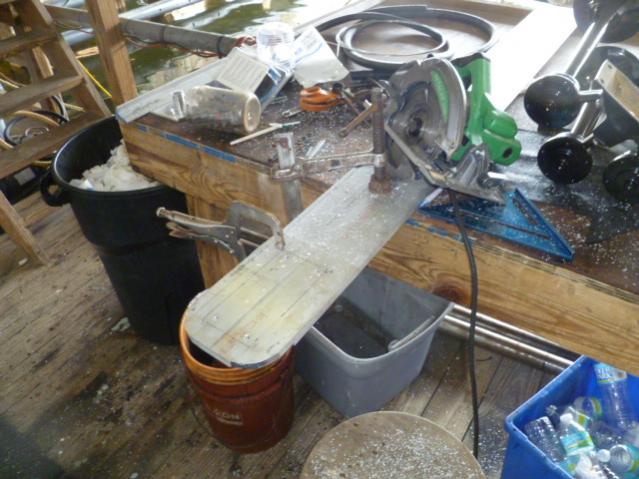

    i do all my cutting with a hitachi 7 1/4 circular saw and 10 dollar blades. i'll bet you could use some electric double cuts. i own some but they are for up to 16 ga; they do make more powerful ones though.

    hate to hijack a thread but it never hurts to let people know what they can do with a cheap saw. here's some pics of a doubler plate i made to mount a horn on an aluminum workboat. it is 1/2 by 6 AL/FB.
