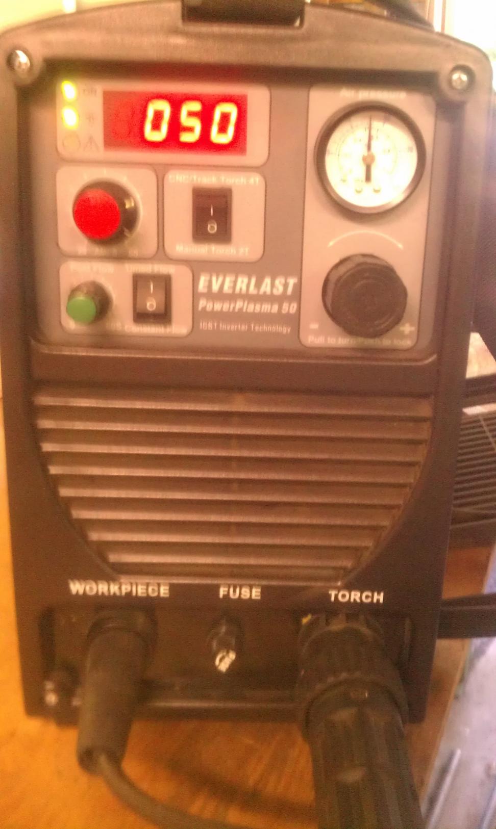

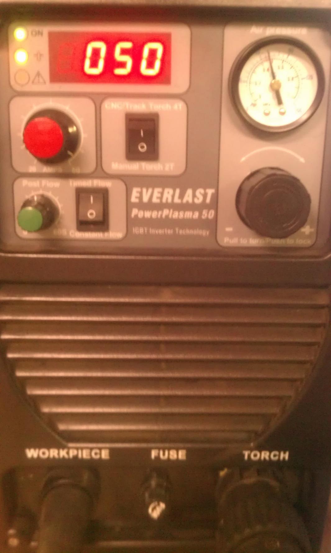

    I did pull the torch apart today, just for good measure. As I said in my original post, the unit acknowledges the trigger pull and starts the air. There is no pilot arc and therefore, no cutting. Below is a pic of the unit just powered up. Click image for larger version.

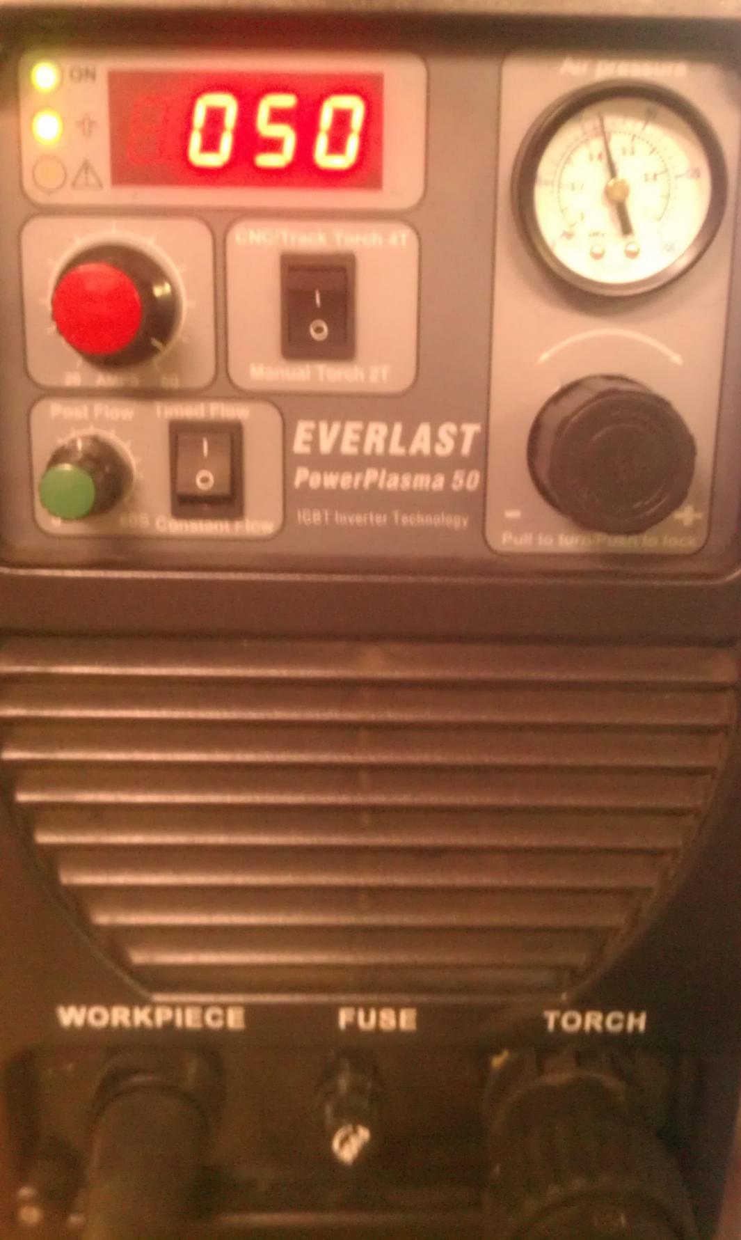

ID:	7506 And below here is a pic of the unit after pulling the trigger, with the air flowing. The only change from pic one to pic two, is the air pressure reading slightly lower because it is flowing. It flows for a few seconds(with flow time all the way left) and stops.Click image for larger version.

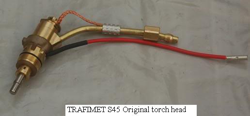

ID:	7510 you said you changed consumables but did you try another end the chrome screw in tip . i have had some bad ones were they was plugged also make sure there's nothing blocking the hole it screws into. and also check the torch wire connections inside machine / cant believe i am saying this also my older pp50 did sorta this once I blightly smacked the machine on top with my hand and started working and has been working fine since now
