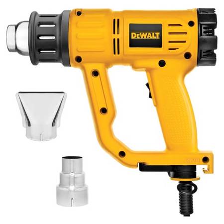

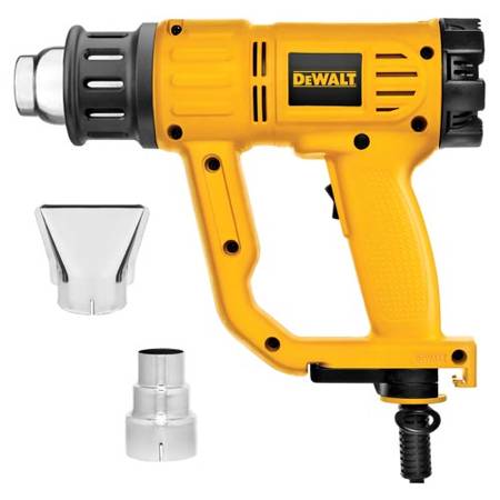

    making the seat and back is easy , i do jet ski seat seat covers at my shop all you need is a heat gun and a air powered staple gun . when you heat the vinal its very easy to work with Click image for larger version.
