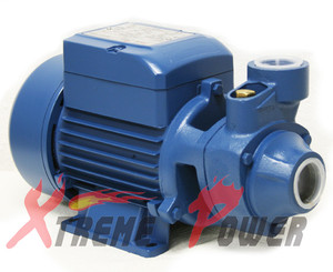

    Has anyone used a motor like this? It is 120 volt and made for pumping water and such....farm pump. 1/2 hp 500gph for $39 bucks? Click image for larger version.
ID:	9212 Found on ebay http://www.ebay.com/itm/370558591841...84.m1423.l2648

    Way over the top for a TIG cooler. Even the large Procon style ones are 100gph or less.
  10. #30
    You can get the procon pumps for $80 or so new from even Grainger. Also, ebay has them, soda vendors use them and I have seen used ones on there.
    The well and irrigation pumps are overkill, waste of power too. That price looks good though.
