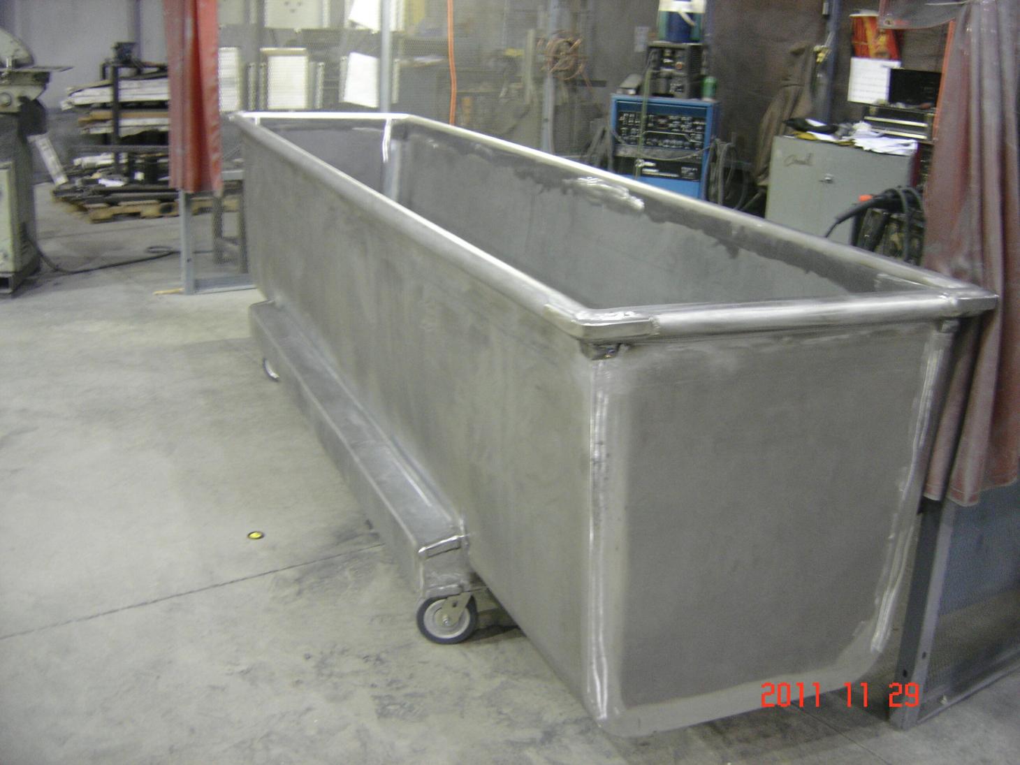

    This was a huge bread dough tub i had to make at work,lot of weld then grind then weld and grind some more ,took almost 40 hours.The tub had to be flawless on the inside so no pits good be seen.

    don't make this an inquisition, provide the information that you yourself would want to know if someone else had posted it. material? thickness? how the bends were made? 40 hours to grind? weld and grind? you know; just the facts.

    That welder in the background is a aerowave..and the material that was used was 12 ga. coldrolled an it was formed on brake press in 2 halves and the ends added on .

    So it's not stainless ?

    or aluminum, like the hobart mixers. well after doing a little research it appears that they no longer use the large aluminum mixing bowls. times have changed, there must have been a health scare that i missed..

    nope not stainless ,they power wash them down after each mix and gets completly coated with vegatable oil each time,but i am told i will be making 2 out of stainless.

    The company i work for made these for another company we are a job shop so i do all kinds of different things,we are not in the buisness of making bread.
