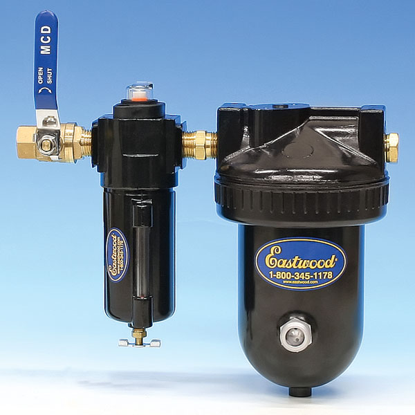

    I have a PowerPro 205 and just cut some 3/32" sheet aluminum. The settings were 35 Amps and 35 PSI. After 4 feet of cutting it was making wide, messy cuts and the plasma tip hole was opened-up and ragged. I was using the wire nozzle spacer that comes with the torch and was using a guide to cut straight lines. -Nothing fancy. Seems like it wore-out pretty quick. A few questions...

    Sounds way too low on the pressure. It depends on the torch you have. Check out the following video for a few tips and settings.
    Much thanks! Yep, pressure was too low and it's humid as heck today -and I don't have a dryer on the line... I'll take care of that.
    Ray
    OK, put a dryer in line and put the pressure up to 55 PSI. Everything's peachy now. Works good.

    So what color was the big box where you got that little dryer? I don't ever recall seeing those before.
    I got my dryer from a friend who happens to have one he salvaged. It's similar to this one but only had the dryer part. The desicant was saturated and I had to cook it a while in the toaster oven. Now I want to rig-up some valves so I can switch between dry air for plasma machine and normal air for general shop work. I think these things cost about 100 bucks so I'm happy to have got mine free...
    You mean this one? http://www.harborfreight.com/inline-...ter-68215.html
    They work very well for the price, some people bake them back to the blue color. You can actually open them and replace the media too.
    Yep, Harbor Freight. 8.00. They have/had the replacement silica for it too. Good quality.
