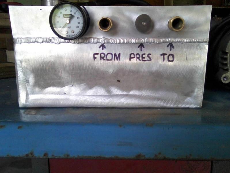

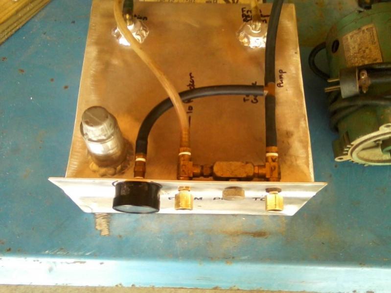

    Just started my water cooler a couple days ago. Got the tank done, the front panel(the picture was taken before I added the power switch), and the plumbing mocked up. I ground the welds off the tank because although it's water tight and doesn't leak, the welds weren't up to my standards on looks. The weld I left on the front was 'OK' seeing as I've only been working with aluminum for about a week. I have to get a pump and heat-exchanger, most likely these will come from ebay as I've seen a few of each on there that I think will handle the job. The valve on the front is a needle valve that bleads off pressure if it should be needed. I'm hoping to have a properly sized pump and not need the valve. What PSI are water-cooled torches supposed to be run at? Flow rate? On with the pictures.

    You don't want to go above 50 psi but you should hook it up without the torch at first and adjust the PSI to about 25 and hook it up to the torch. Because of the restrictions inthe torch the pressure with jump with the torch in the circuit. Also you want about flow of about 1/2 Gal a minute (may be a little off on that).
    Procon pumps on Ebay is what you want. Punps have a pressure release built in so the valve would not be needed.

    The Procon pumps have a pressure relief valve in them for adjustment. You should use that or a regulator not just a simple needle valve as the volume can change quite a bit as things heat up and depending on how the hose drapes. Flow is very low and depends on the torch, but typically less than 1 gallon a minute. But it is imperative that the flow be constant. It doesn't take much to fry a power cable. CK Worldwide makes a nice fuse block that will provide torch and cable protection in case of cooling failure. The fittings you will need vary depending on torch manufacturer. Many use the inert arc sizes (3/8-24, 5/8-18, 7/8-14) but often with left hand threads to insure they are not mixed up with argon lines.

    A Procon pump was what I was planning on going with. Thanks for the tips on the flow and pressure. I planned on hooking it up w/o the torch and backing the pressure way off, then hooking up the torch and raising it to a proper level. I should have been more specific about the needle valve I'm using, the needle is spring-loaded against the knob, it came off my car where it was used to adjust the oil feed pressure to the cylinder head. I built a "Frankenstein" Chrysler engine where I had to run the oil-feed to the head externally and this valve was used to regulate the pressure to the head. It worked well and held a solid pressure, even once the oil heated up and thinned out. Like I said, the valve is only in there as a "just-in-case" scenario. I plan on getting a Procon pump with the internal adjustable pressure relief adjustment thingy. As for the water line fittings, they are the proper left-hand threaded fittings. My welder had a water solenoid on it for use with a non-circulating water supply and I just took the two fittings off the solenoid. They are adapters from the female LH-Thread water fittings to 1/8" NPT threads. Anything else that I should know about building this water-cooler that I hadn't thought of just yet? Thanks for the help guys.
