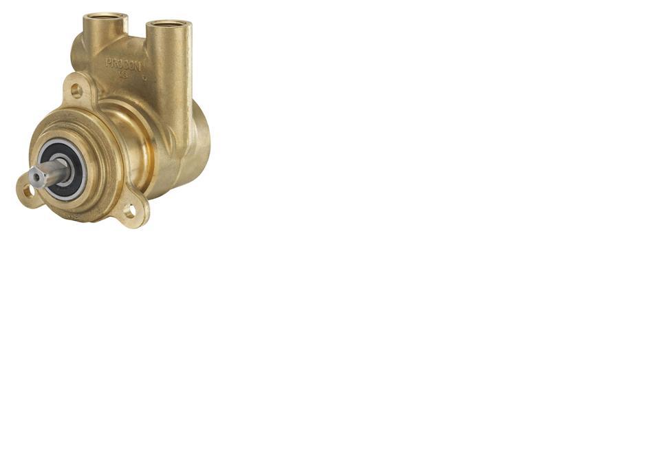

    I'm looking into a DIY TIG cooler, and want to see if I can connect a Procon pump to a motor I have. Is there a specific name for the "round shaft with a flat surface" on this pump? I want to see if McMaster or a similar outlet has a fitting for it.

    What you need is a shaft coupler. There are two ways to go, one is to use a solid coupler, and then the pump basically hangs on the motor. Then you use a small reaction arm to keep the pump from spinning. This is done on motors with good quality end bearings. The other way is to mount the motor and pump solidly, and use a flexible coupler between them. These are made by Lovejoy and others and deal with small amounts of misalignment. What you can't do is have a solid coupler and solid mountings. It will damage both pump and motor.
    Thanks for _that_ heads-up, I'd already started walking down that road. Time to reconsider! The motor I have is set up for belt drive; maybe I'll give that a thought. The thinking through and designing and problem-solving is fun, but hard to pass up a pre-built setup like the one Rod posted.
    Here is another procon type pump, these are used for coffee machines, You can use a love joy type coupling , a chain coupling , or a flat belt flex coupling to hook to a motor.

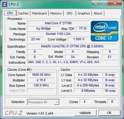

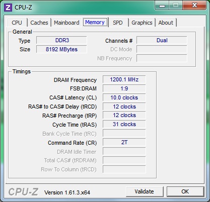

    I disagree. Ready built computers usually have a one part selling point like the processor, while the rest of it's parts are low end (motherboard, memory, power supply, hard drive, case). You can have all have all high quality (Faster) parts for about the same money, and a clean operating system without all the garbage/spyware that comes with a pre-installed OS. You also get to put it all in a quiet case that you like.

    Looks like it's called a "D-profile shaft". Although, I think I'd also just call it a "Shaft with flat".
