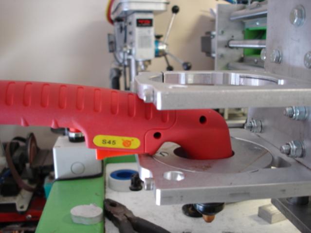

    The Power Plasma 50 should work fine.
    The PP 50 should work fine for this application. However, you may find some issues in the torch adaptation, unless you fab a holder for the torch. The machine torches we stock are HF only right now. We will be getting other style torches, but right now, you may have to source a contact start machine torch from a torch company.

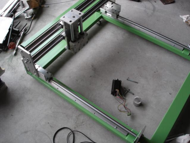

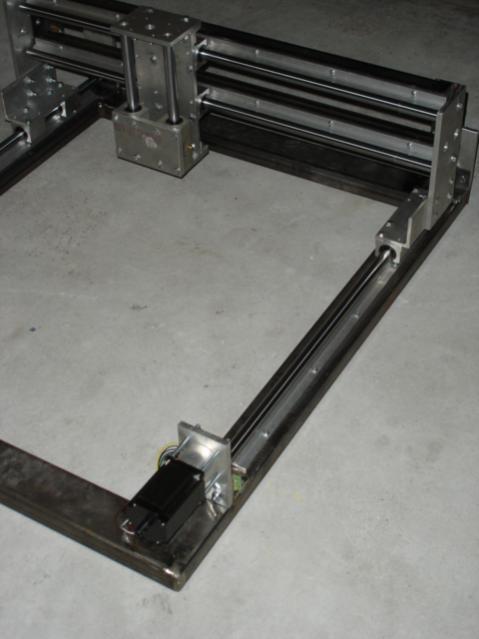

    Could you give me some information on your TorchMate setup? I made my CNC table with the intent of only machining wood and metal. Using it for plasma cutting is a little different and I have little experience with automated plasma cutting.
    Does your setup use a torch height controller on the Z? If not do you just set the Z to a preset height away from the material? Do you have a different pierce and cutting height?
    Does your setup monitor the status of the plasma arc somehow? If so how does the table know if an arc is being maintained or if the arc has dropped out?
    What values are you using, if any, for dwell (I think G4 codes)?
    I machined a holder for the torch and have done some initial experiments with triggering the torch manually and it seems to be ok. I have to get a breakout board and build me some isolated triggers for the torch. If I get some time I will take some snapshots of how I have it mounted now. Maybe we could make some comparisons and I could pick up a few tips?

  7. Default My hardware and plasma holder
    I would like to see Everlast offer a straight torch in the future as an upgrade. In the meantime I have machined the torch holder shown in the attached pics. As you can see my machine was primarily set up for use with the Porter Cable router. The holder I made just slides in the same hole the router normally sits in. I have also included some photos of the various stages of my build.
    Geezer, for the most part the Torchmate deal seems to be a convenient way to get into plasma cutting because they offer all the software tailored for the task. For me it is a little different. I am using Mach3 and CamBam software to drive my table. Mach3 can be configured for router, laser, waterjet, plasma etc, but it requires a very good understanding of the particular process you are running. For example when I am cutting wood or metal my plunge cuts could usually start anywhere. With plasma you have to offset your plunge cut (pierce) and then transition to your cut to get a smooth finished edge. From my understanding these offsets (I think they are called Lead Ins/Outs) are handled by the cam program. Maybe the cam program I am using is not really suitable for plasma as I have not seen any settings for Lead In or Out. Someone on another forum recommended SheetCam so I might give that a whirl.
    So I am glad I will not have invest in torch height control. I am still curious to know how your table knows whether ignition has taken place. You obviously have the trigger switch routed to your controller. Is that the only control that your table uses? Is there a current donut or something you place on your cables?

    Your set up for the torch holder looks just fine, the machine looks great,as far as a feed back loop or donut sensing ring on the cables, there is none. Cadlite from torchmate is used to set male or female entry paths on the parts to be cut, other programs can do the same.
