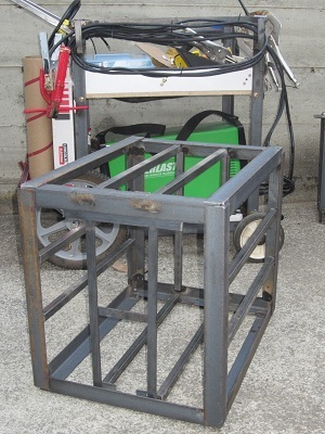

    A customer approached me to create a steel enclosure that he could bolt to the inside of his SUV. He wanted it to look "beefy" but didn't want to spend too much on material nor my time.
    Started out with a typical rectangle using angle steel:

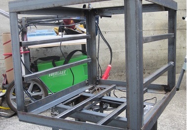

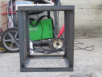

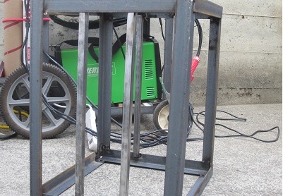

    I used square tube for the bars for each side to provide that beefy look.

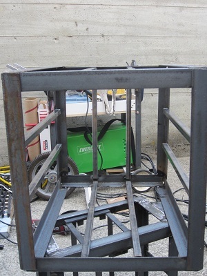

    Created a simple door that locks with a conventional padlock of the customer's choosing.

    Out of curiosity, why not the square tube for the whole thing?
    Does the one end unbolt or something to be used as a "door"?
    Definitely looks heavy duty.
    Edit: Nevermind, I see that you posted about the padlock...I guess I need to read instead of just looking at the pictures...
    Did he mention what he plans to lock up? It's something big enough that it could not fit through the gaps between the square tubes- probably not small electric tools or hand tools, for instance. How does he plan to bolt it inside the SUV, I wonder? His problem, not yours, I know, just curious.
    What in the world is that!
    He was very specific about the maximum distance any two bars could be from each other so I had to work within his specs.
    "As little money as possible" was the primary driver so I didn't even use a hinge for the door. The door slides into grooves and will held in the grooves by the padlock. And, no worries, I'm a pictures type of guy too.
    I've only got the angle grinder with a cutting wheel at the moment so I'm working around miter cuts. Besides, I saved some labor by using the angle on the outside and welding the tube to the angles and not worry as much about super precise measuring and cuts. Oh, and the angle steel was cheaper than the tube but from the side, it has a wider profile to add to the beefiness and to fill some space so that I wouldn't have to use as much steel. Couldn't use flat steel (1/8") for the bars as they bend too easily across such a large gap.
