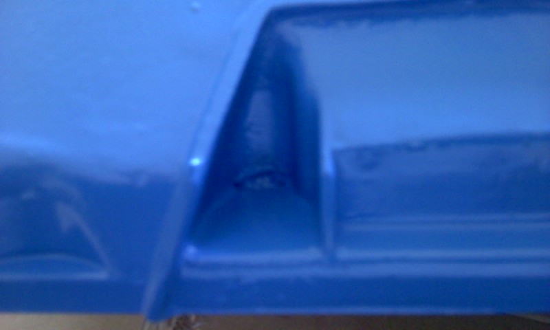

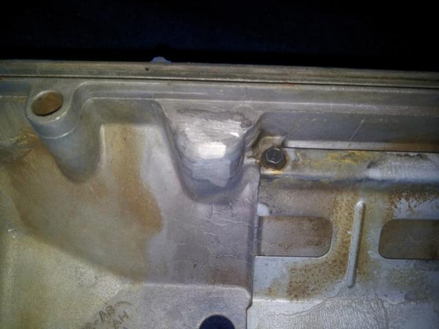

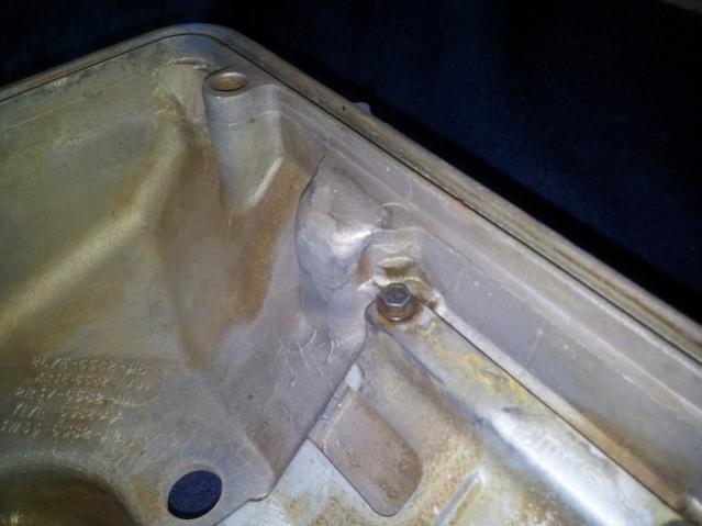

    Had a friend with a cast aluminum valve cover who had accidentally ground a hole in it when trying to add some clearance. He had patched the hole with epoxy but now wanted to get them powder coated so the hole had to be plugged. We burned the epoxy out and then used my soda blaster to clean the remaining epoxy off. I heated the area up with a propane torch. I had the amperage set to 150A, the frequency was set to the highest frequency for a PP256, and the AC balance was set to about 65%. I was using a 3/32" 2% thoriated tungsten and a gas lense. At first the arc was erratic until I finally got a little of it to pool and got some filler rod to flow. Then I brought the filler all the way around the hole and slowly worked towards the center. The more filler I got the better the arc got. After I got the hole closed I hit it with all 150 amps and reflowed the pool. It came out pretty good. In retrospect I think the 3/32" rod was too small for 150 amps since the end balled up towards the end. I think welding tips and tricks.com helped quite a bit but does anyone here have some additional tips? I think there will be more cast aluminum repairs in my future!

    What filler did you pick (4043)?
    Maybe get pictures even after powercoat. Sounds like a good job and good time. The higher frequency will yield a narrower weld with a sharp point. Probably didn't need more than 120-140Hz (2-3 o'clock on the knob).

    How big of a hole was it? When you patched it, did you build up on the outside, since apparently it was a clearance issue, or was he really overzealous with the clearancing and bringing back to stock left enough?

    Sorry, I never think to take pictures. I'll ask him to snap a few when he gets it back from the powdercoater. I made the repair on the inside then we filed it down to fix the clearance issue. I couldn't weld it from the inside cause it was a deep recess from that side. And yes I used 4043. Seems like 4043 is the most versatile aluminum filler.
    Finally got some pictures!

    Thanks for posting pictures Ron. Guess it really did happen . Looks like a good repair.
