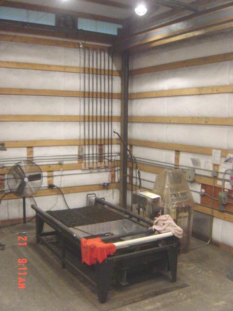

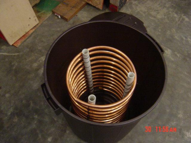

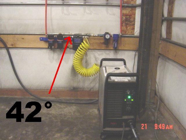

    Here are some pictures of an air dryer I built years ago.
    Well the pictures didn't up load in order!

    Post #10 in this thread http://allmetalshaping.com/showthread.php?t=1424 has an interesting idea for a simple water cooled dryer. I might just have to try something like that.

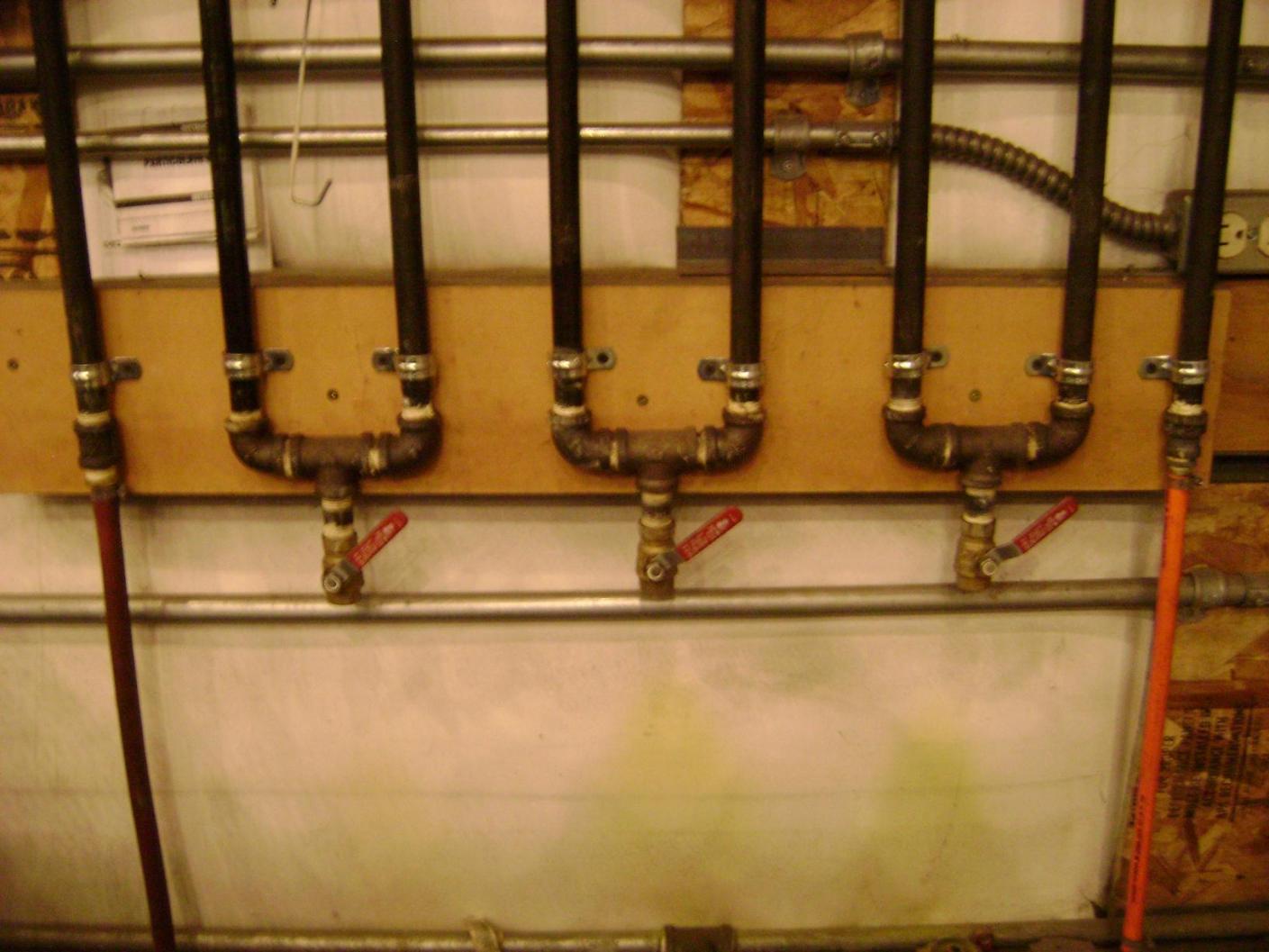

    How do you drain that? The secret to getting dry air is to keep the moisture that has been removed from the incoming warm air away from the newly dried air. That is the problem I see with the idea of using an air conditioning condenser. The condenser does cool the air but there is no way to drain that moisture out of the air stream quick enough to keep the newly dry air dry. It will pick up the condensation in the condenser and make it wet again.
    That is what is nice about the franzinator. It dries the air and keeps the dry air away from the moisture. It also makes the air change direction which also makes the air dryer. Plus it is so simple to make and does not cost much. It is a tried and true idea that seems to work really well. So far I am happy as can be with this simple thing. I'm pulling lots of water out of the air and it is making my plasma cutting much easier. Plus my tools don't have any water coming out of the exhaust ports any more.

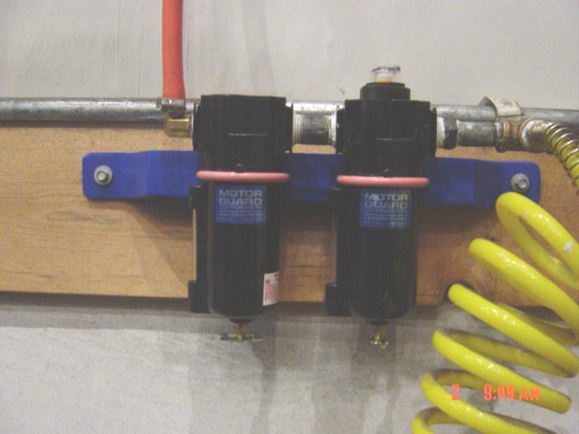

    The system has 6 drains.

    Quote Originally Posted by Shield Arc View Post
    I think 6 drains will work just fine! That is quite a set up there. Very nice.
    I have three drains as my system is portable. One on the Franzinator, one on the main tank and one on the external filter. I can move the tank to where I need it or if I need to paint and don't want the air compressor in the same room as where the painting is being done. That is what I like about the Franzinator is that it is so simple and not very expensive. My filter life in my Motorguard filter has been extended by quite a bit since installing the Franzinator.
    There are quite a few ways of removing water / oil from the air and the Franzinator is probably the simplest answer I've found so far. I like it because it is almost impossible to damage as it is just some pipe and fittings. It takes up a very small area and costs so little. Again, it does not remove all the water but this with a good air filter and it will get almost all of the water out.

    I had a HVAC engineer friend of mine walk me through the build. John, (Franz) added his 2-cents also.
