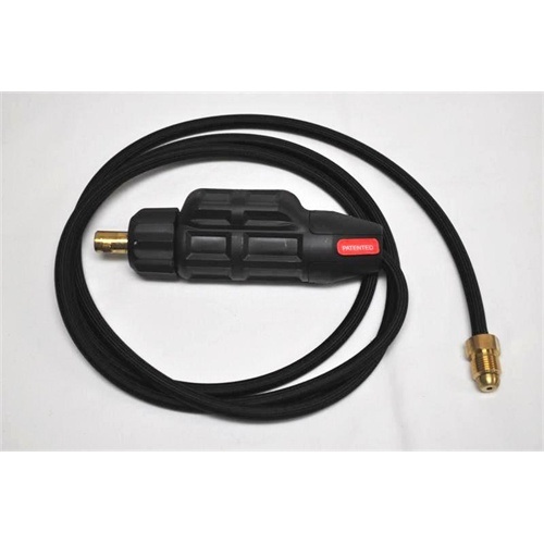

    Mark I apparently ordered the wrong dinse for the CK 9 torch and ultra flex cable. I ordered the SL2-35LG but understand it should be the SL2-35. However before ordering another wrong part I want to be sure. This is a picture of the SL2-35 but the little peg at the end that locks the dinse in after twisting seems to be to far from the end. That is the issue I have with the other dinse with the "LG" suffix. Any help is appreciated to help me avert ordering another wrong part. I am excited to work this torch and hope I find the correct dinse for the cable. Dan in NYClick image for larger version.

    SL2-35 is a 35-70 dinse, adding LG just changes to a male gas quick coupling instead of the threaded gas fitting. What are the numbers on your oem dinse ?
    The barrel look a little fat. Not sure how that is going to affect the fit. The Dinse is a 35-50 I believe, but a 35 70 will generally work. It might be a little long, but it can be made to work.
    The first time I used my CK dinse it took a little extra force to turn it to the locked position, after that it was easier.

    I got it to work because I unscrewed the plastic nut that locks the two halves of the cover and left that nut off. The dinse then plugged in perfectly. I am using a 25 foot ultra flex cable with the 130 amp CK 9 torch. Now that it is dialed in I love it. What a pleasure. I know there is a time and place for the 26 torch, but for the majority of what I do now and will do the small torch and flex hose will be perfect. Thanks Piopio and Mark and all who helped. I am up and running now. D
