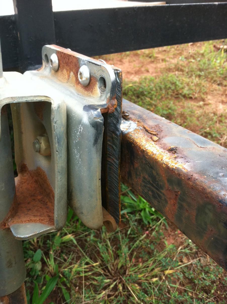

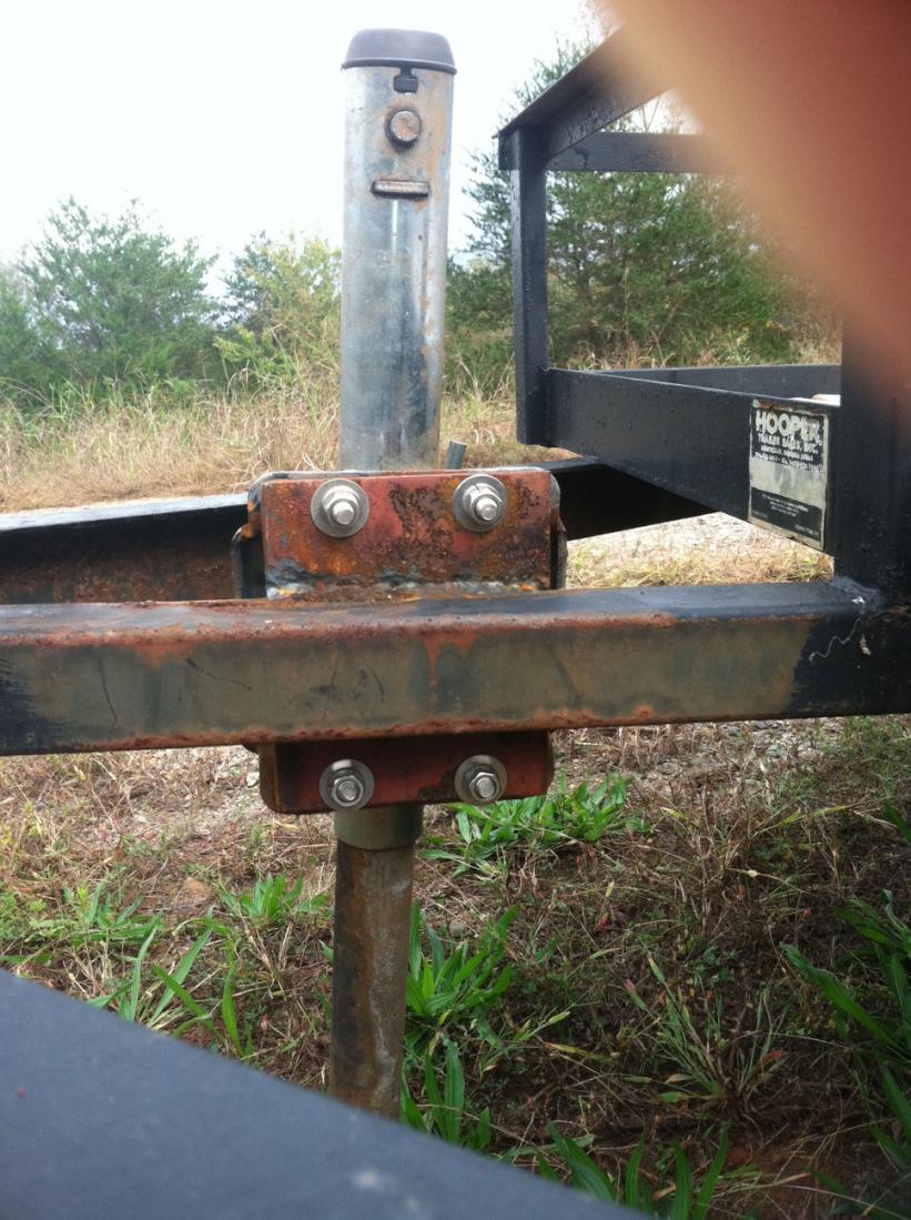

    You are going to want to make a mounting plate for that trailer jack. The long bolts and thin metal clamps will do nothing but bend once you have a lot of weight on it. Something like this:
ID:	8799Click image for larger version.
    Mine isn't pretty but it works very well. Hope that helps.

    With the jack mounted to the sliding part of the tongue, how are you going to take the load off so you can slide it in and out?
  10. #50
    I have been thinking of a solution to that. Any ideas? A tongue box will cover the tongue completely. I was thinking of maybe some kind of jack that mounted on the bottom?
    Purple Fabricator 211i
  11. #51
    I'd say just leave the clamp on mount until you get farther along. Maybe something will present itself as you get more done. You might be able to fasten the jack to the tongue box. It's not like this trailer is going to weigh a lot. Of course you could get real tricky and put a powered jack inside the tongue box.
