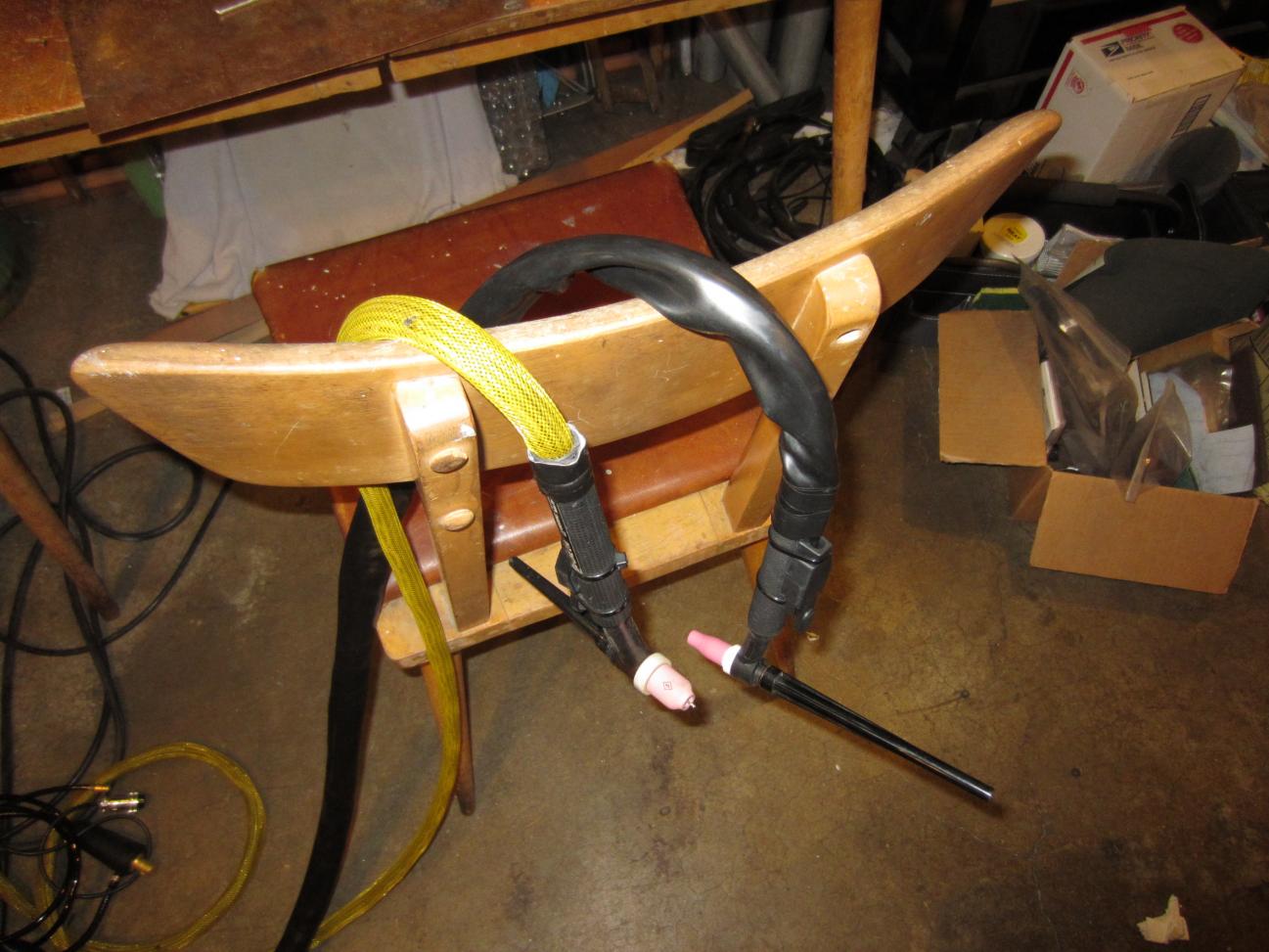

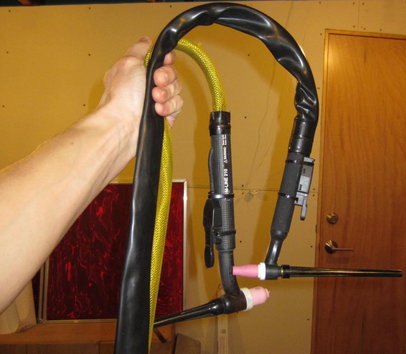

    Also, I suggested earlier that I could take some comparison pics of the Everlast WP20 with the CK Trimline 210 Superflex. Despite your mentioning that you already ordered the WP20, I'm going to follow through with it:
ID:	8476 Click image for larger version.
    I tried holding them both pretty much vertically and let them "droop" how they wanted. The WP20 actually had kind of a set curve to it (and for these pics, I actually had it oriented so that its natural curve would, in combination with gravity, produce the tightest possible bend.) The superflex cable as you can see, is quite limber.
    PS - there is a "custom" braided cable cover on my TL210 superflex (and I've posted about this before), as well as the stubby gas lens collet body I was mentioning earlier. One thing a bit funny about the stubby setup worth mentioning is that the back cap isn't quite long enough to accommodate a 7" long tungsten.
    I hope this info is helpful to someone.

    The pics you posted are very helpful, and in reality, it looks like BOTH have a smaller radii than the WP26 I have now. I also went ahead and ordered a 1/16 and 3/32 gas-saver setup for it. Figure I might as well, I needed some 316L and 1/16 309L filler for some upcoming work, that covers the shipping and the gas saved may offset the cost there.
