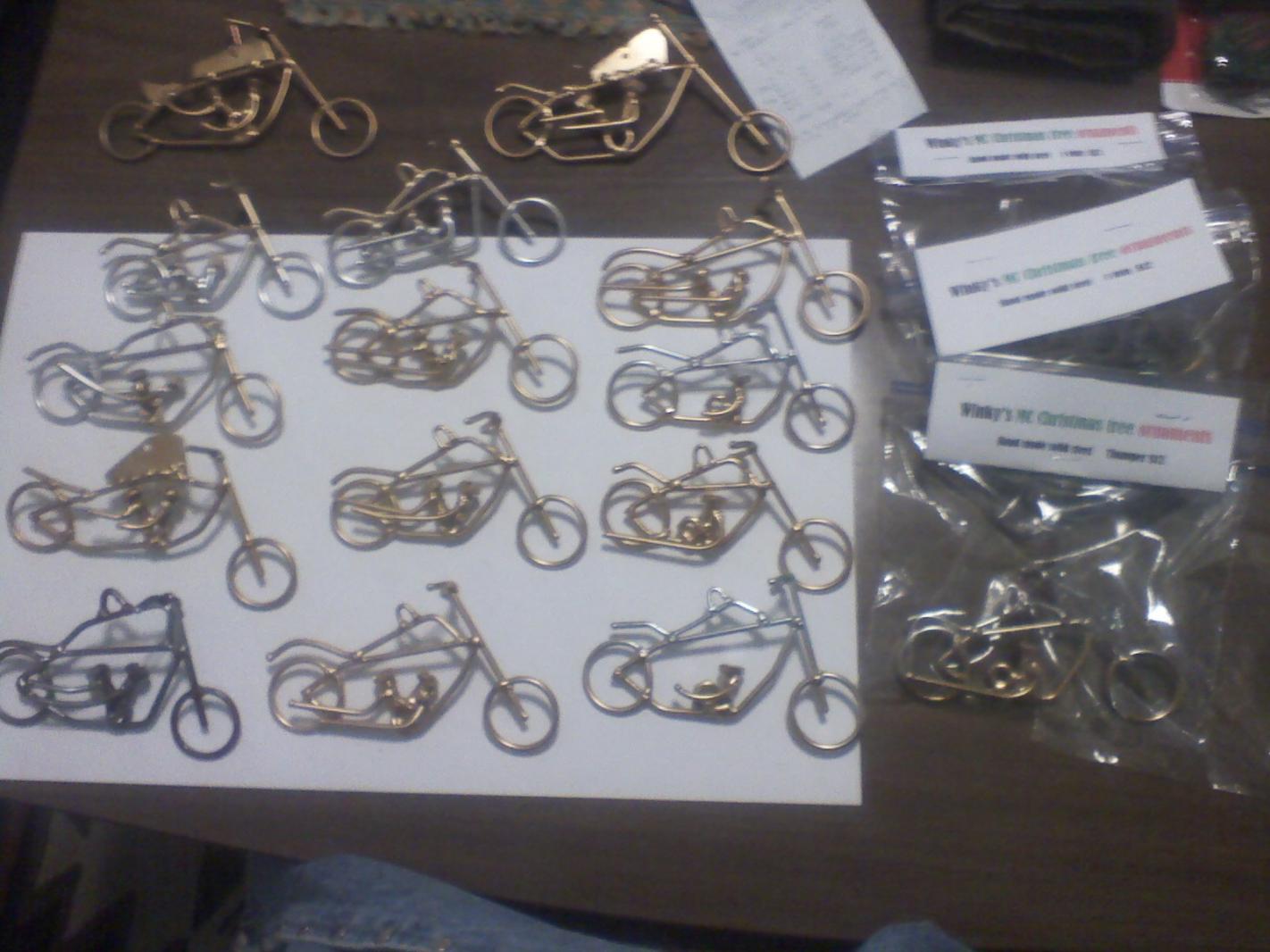

    Why not ... I made motorcycles to hang on Christmas trees so why not welding rod?Click image for larger version.

    Hey Winky,
    You were using MIG on those right? What type wire are you using for the frames? They look slick.
    Hey Winky,
    I was using 1/8" cold rolled round stock for the entire bikes. Yes, I migged them with my 180C Red using .030 ... they are fun and easy to do and sell pretty well.
