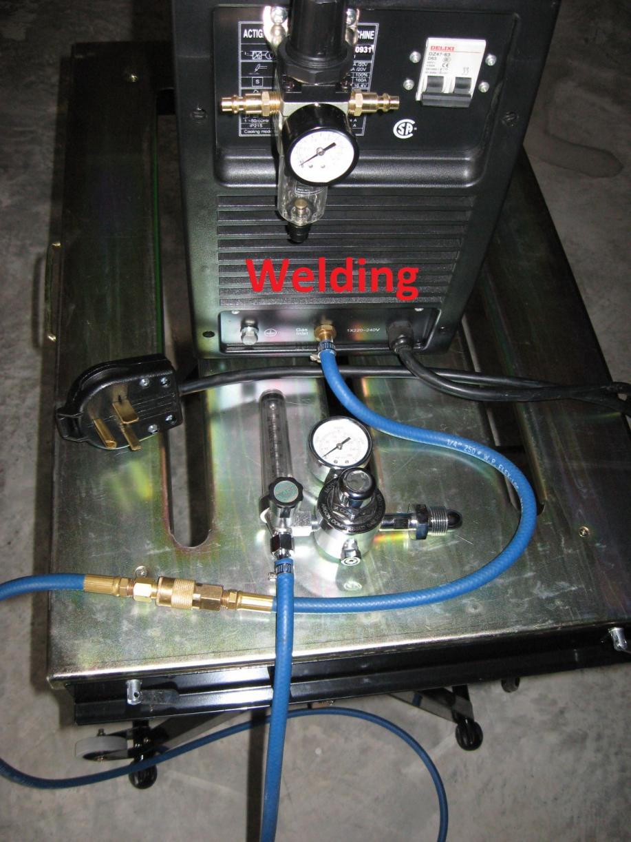

    You can buy a cheap 10' air hose, cut off the piece you need and put a quick coupling on the end and on the air dryer. Similar to this Click image for larger version.
Name:	IMG_1155 - Copy.jpg
ID:	8546 Makes it easier to transport if need be.
    I used 1/4 to 1/2 bushings (not needed for M30) and put a male QC on both sides of my air dryer so I can just plug it in like any other air tool.

    My pic was a PP256, the PP50 has an internal regulator so there's nothing to bump. I don't have the regulator mounted on the 256 anymore since I got a PP60... I have a male QC on my argon regulator hose and took those pics to show how I switched between cutting and welding.
