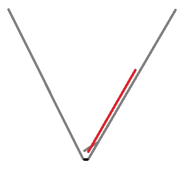

    I think adding a ledge inside the cabinet just above the pickup would stop the material from packing around it. Click image for larger version.
ID:	8972 I'm building a cabinet now so I'll give it a try.
