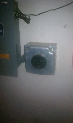

    So I just got a Powertig185 and want to wire it up. The attached picture is what I have on my wall. It says Nema-6 250V on it, but looking it up, there's a ton of different nema 6 plug types. Sorry for the crappy image quality it was a cell phone pic. It has two horizontal pins the same size and a round pin below that. So what should I be looking for at home depot tomorrow? Also, the powertig is a dual voltage option so is there anything I need to do to the welder itself to select 240 Volt mode or will it pick it up automatically?

    Can't really see the pic, but from what you describe you have a NEMA 6-30R outlet there. It should also be marked that, somewhere. The plug you will need is a NEMA 6-30P. Home Depot often sells a NEMA 6-30/50 plug that you can assemble either way. It comes with loose blades and a + hole so the blade can be installed either vertical or horizontal.

    2 horizontals and a round could be a 6-15 or a 6-30, according to this chart: looks like it depends on the separation between the horizontal blades.
    http://www.stayonline.com/reference-...ght-blade.aspx
    Dual voltage machines automatically sense input power.

    The picture was good enough to see is wasn't the little 6-15.
    Doh! You spoofed me, I thought it was still up in the air. Glad it worked out!
