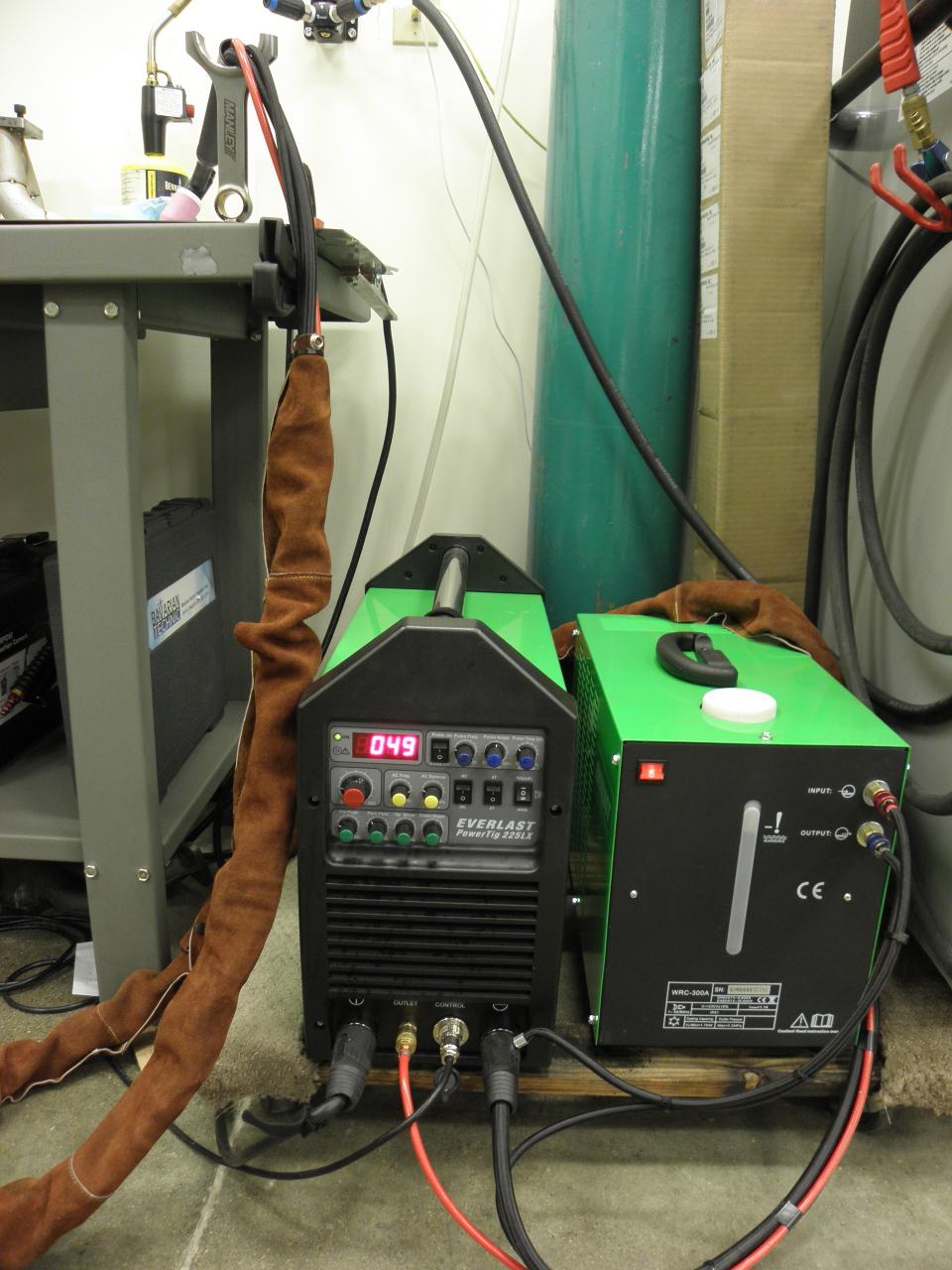

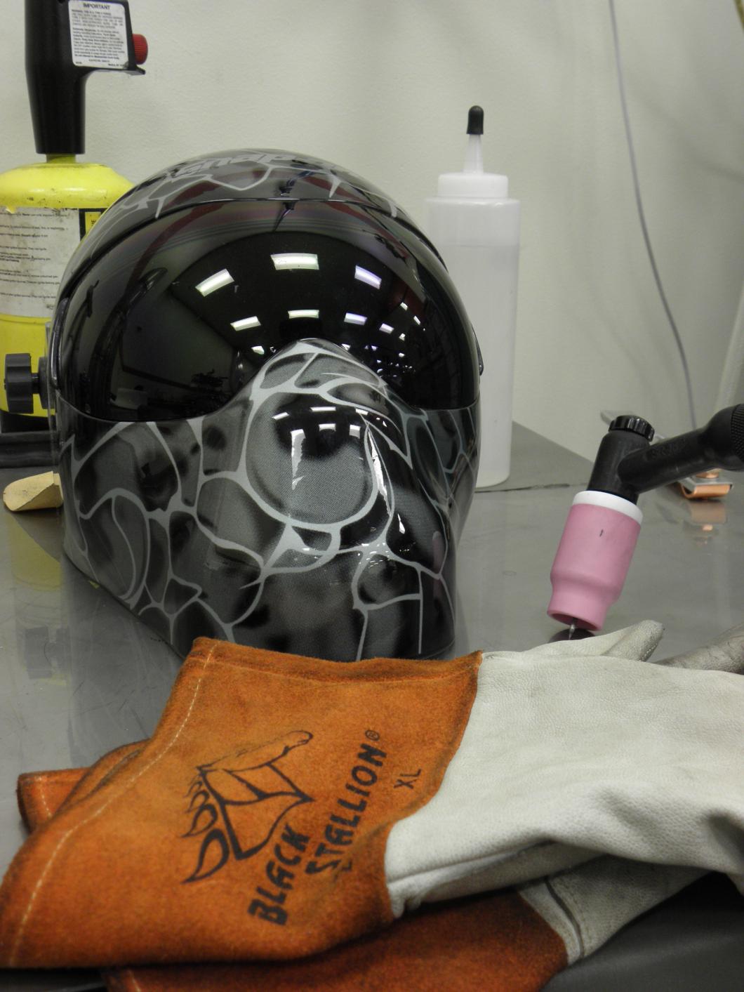

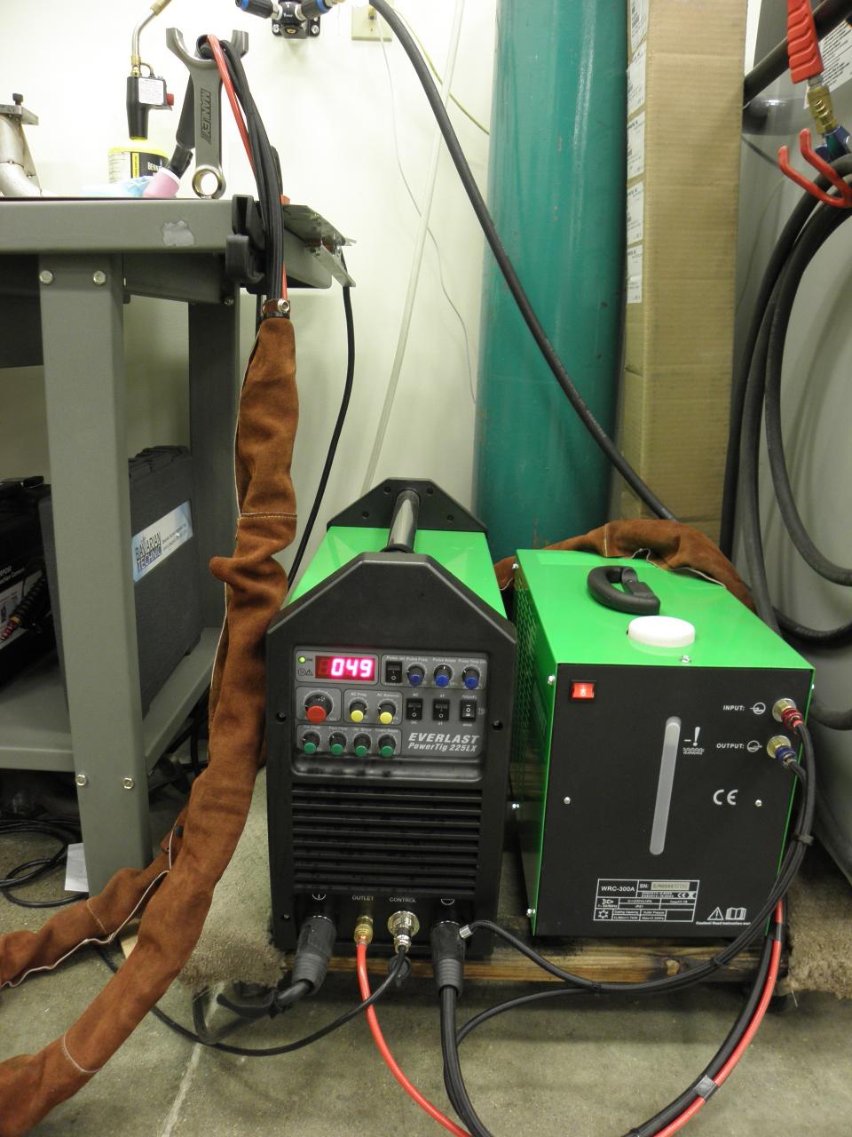

    Purchased and received ( finally ) a power tig 225 LX. Initial impressions are good, machine seems to work well. I do not like how the arc starts due to the rush of argon but is easy enough to work around. The torch is foreign to me, I think it is supposed to be the economy WP18 but I have no idea, none of the WP18 cups/nozzles I have fit? It is NOT the European style torch, it has a all black handle and came with 2 number 4 cups. I want to get another torch for it but the Everlast website just shows a generic picture of then WP20 torch they offer with no real details, does anyone know if it has a gas lense? And how it compares in size to the torch that I got? I am looking to go the CK route but if the everlast has a viable plug and play option then I will consider it. I usually use a Speedway torch and have used Weldcraft products as well. I have never welded without a gas lense and the arc wander is killing me. If it helps I bought the my welder and torch cooler from Alex in California, I guess location makes a difference of what torch you get?

    Just put on a smidge of preflow so the arc starts after the blast. Another guy here likes to bump the peddle to get the argon going and then start to weld, but I've gotten use to the short delay starting. It really makes a difference; just a nice "click" and there's your arc right where you want it. Also get some less flexible, as short as tolerable, and as small an ID line as you can manage and you'll get less blast. IIRC the everlast supplied line is 5/16 ID and I'm using 1/4" which was supplied with my air liquide regulator. That's less than half the volume.
    The side of the torch says SR18, it seems that WP17 components fit it though?? I am actually taking a break from welding at the moment, all of my welds on stainless tubing are very dark, like I have insufficient gas coverage? I tried adjusting flow both up and down with no change, I have confirmed the gas is flowing from the cup. I am still using the #4 cup so I turned the Amperage way down to see if that made a difference, it was very slight. I adjusted travel speed, torch angle, arc length, ect. and it stays the same. Changed out my tungsten to 2% thoriated and still no change? I suspect that the #4 cup is to blame as I can jump right on to the Lincoln 185, same argon, same tungsten and get proper welds, only difference being the torches and cups. Anyone else have this experience??

    Yes, you need a larger cup for stainless.
    The prefix isn't important as the number. All 17, 26, and 18 interchange. IF your 17 cons fit and you have an 18 torch on your Lincoln and they won't fit our 18 you need to make sure YOUR existing torch is compatable with everything else. IF our 18 fits your 17 cons, it's not our torch that is the issue. Because as I said, the 17, 26, and 18 are typically universally interchangeble.

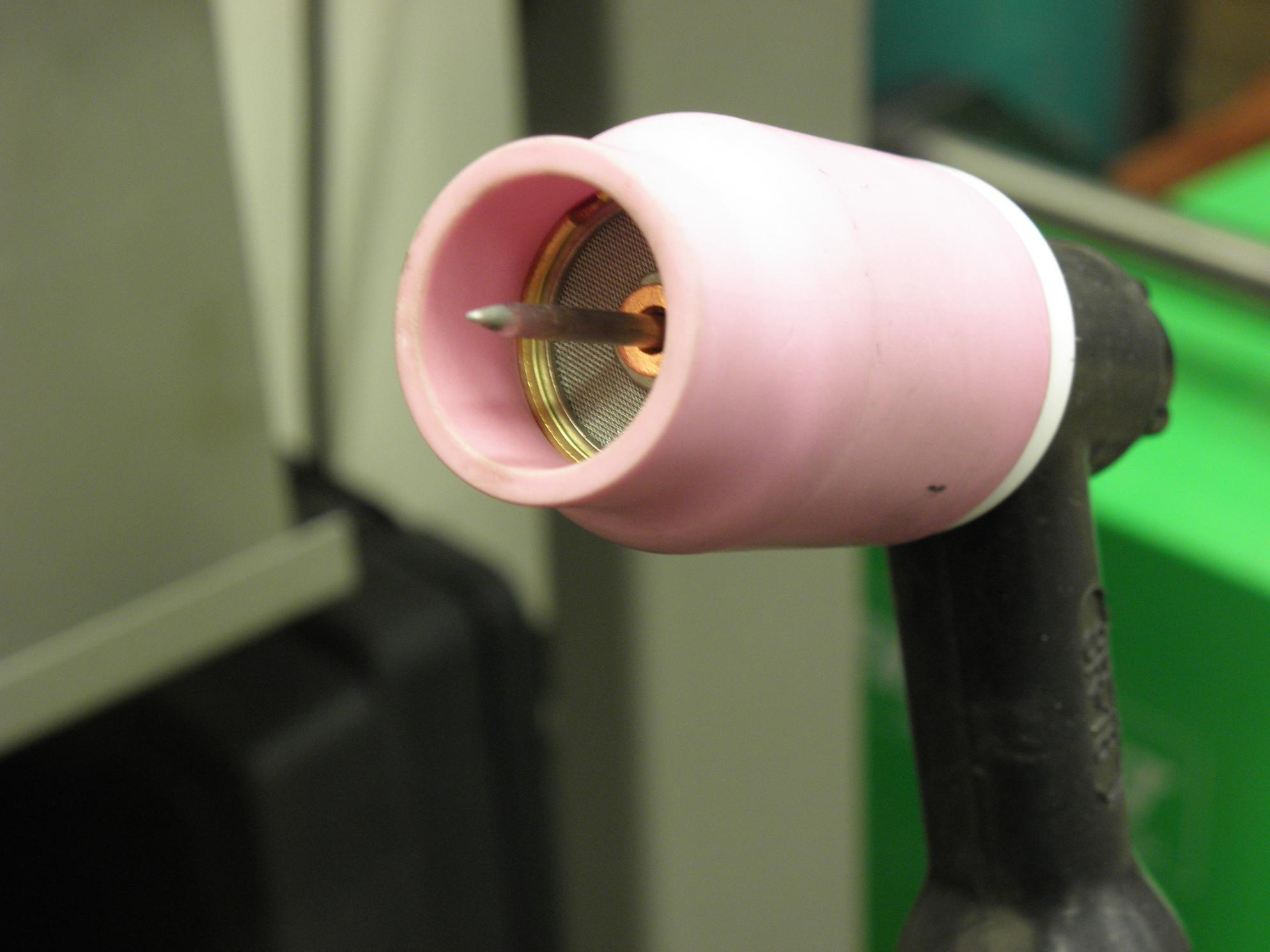

    Picked up a gas lens and #8 cup this morning, WORLD of difference!!! Welds are clean with no oxygen contamination. Everlast retailers should add the $25 it cost for those two parts and include it in the package as standard.

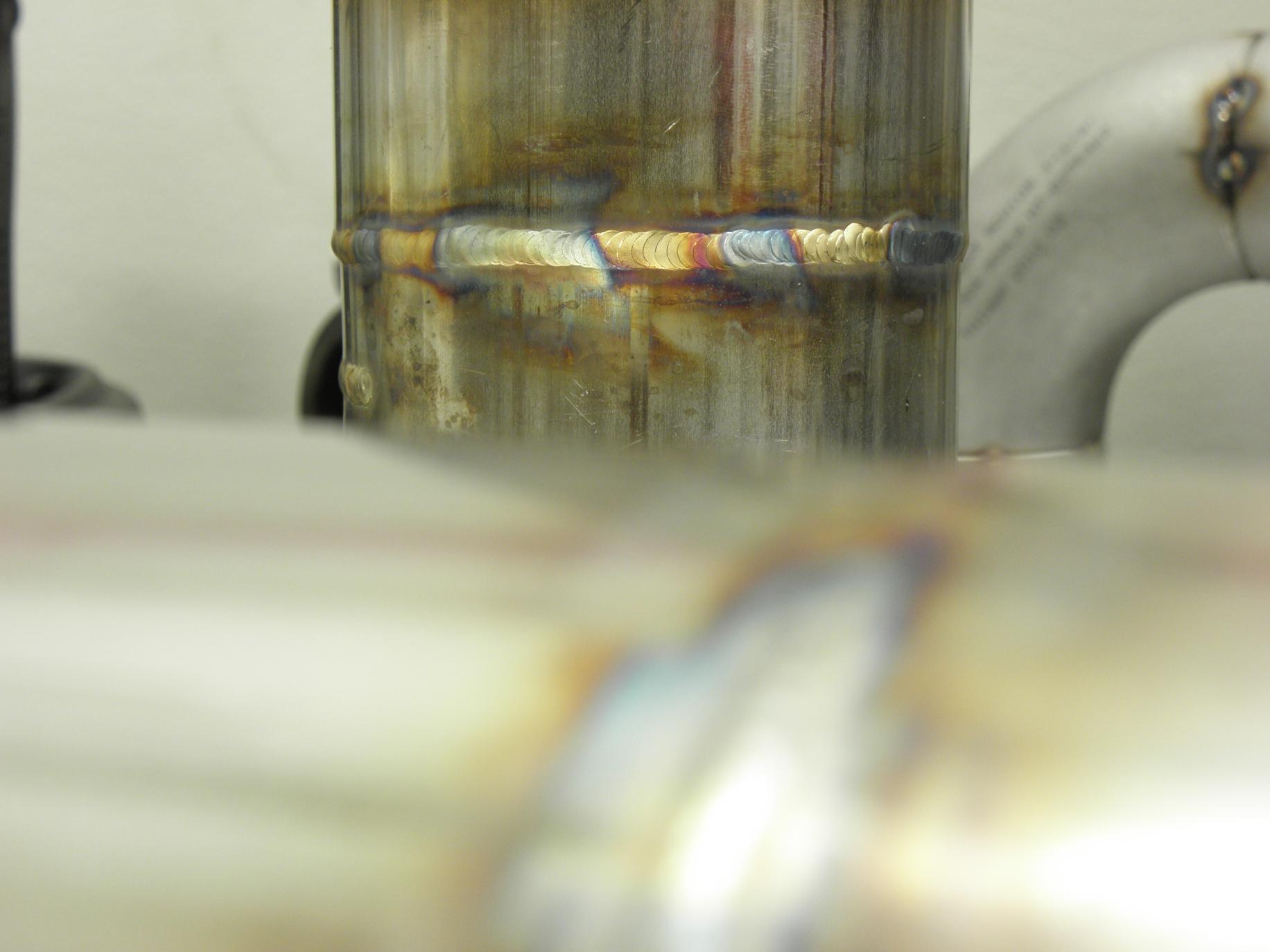

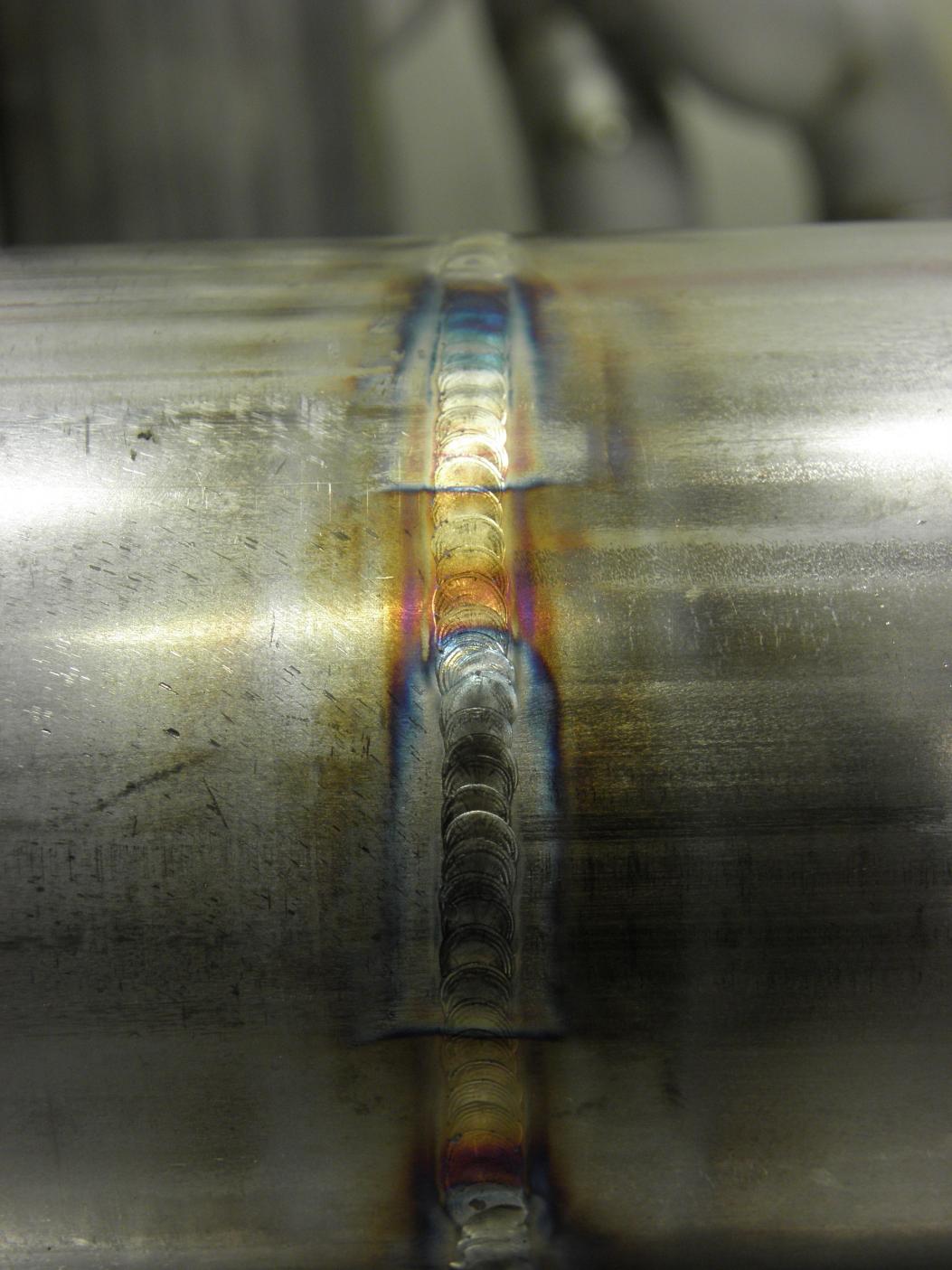

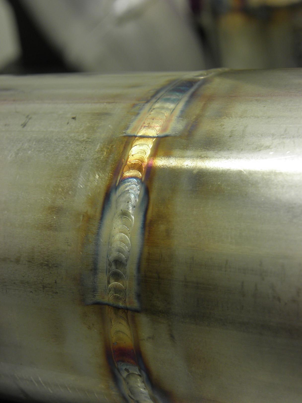

    Agreed, and for the price of a 3 pack of tungsten they could get that in a package as well. I managed to get some time in today on some Docol R8 tube, it is a alternative to 4130. My machine performed perfectly! So far so good.

    Any pics of some samples? I ask cuz I am still trying to figure things out specially with different metals
    Quote Originally Posted by vicrc View Post
    I will snap some pics when I get a minute and post them, anything in particular you want to see?
    Do you have part numbers? I have the sr18 and bought a gas savor CKD2GS33-P but it does not fit.http://www.lascentrum.com/en/tbi+wel...+tig/gas+lens/. I found this link for gas lens fittings
    for this torch I think? Any one know what threads are inside the torch head?
    Quote Originally Posted by gree box View Post
    That gas saver kit is for a 2 series torch (9/20) what you need is 3 series (17/18/26). Basically just change the part number from D2xxx to D3xxx to get the same parts kit in your torch size. On the page you linked to, any in the top two groups will fit. However, each group takes a different sized cup thread. The top group is the normal sized cups, and the second group are the large sized cups. You can use any parts that are listed for SR/WP 18, 18, 26 or in CK series 3. The threads are industry standard across brands. For your torch it's 3/8"-32, while the kit you got is 3/8"-24. Hope that helps.
  16. Default some welding pics
