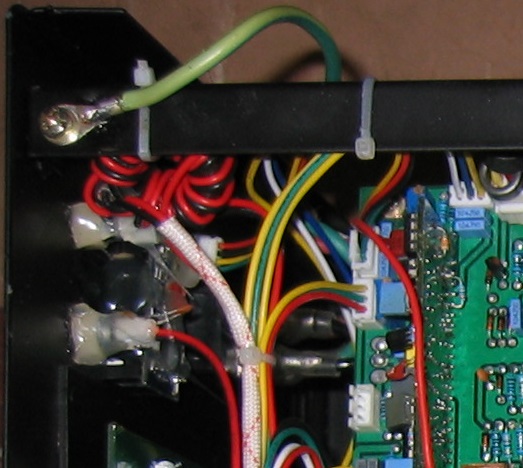

    I have a 2007 Super200P that's probably at least somewhat similar to your Super160P. The digital current readout on my Super200P seems to have a small circuit board built into the back of it, which appears to connect to the rest of the machine with just four wires (red, black, yellow, and green.) It probably takes an analog signal and drives the LED segments based on it. You can see this small circuit board in the attached photo on mine is covered with hot glue:

    If you knew the general specifications for it (e.g., what voltages are supposed to be present on which wires during normal operation of the machine), you might be able to diagnose whether the problem exists in this board using a multimeter, by testing for the presence of expected voltages going to this board.
    If I had to just make a wild guess though, I'd guess that black and red wires are the power supply (with black being ground and red being some constant voltage source), and the signal reaches the board across the green and yellow wires (e.g., a voltage that varies based on the machine's welding current).

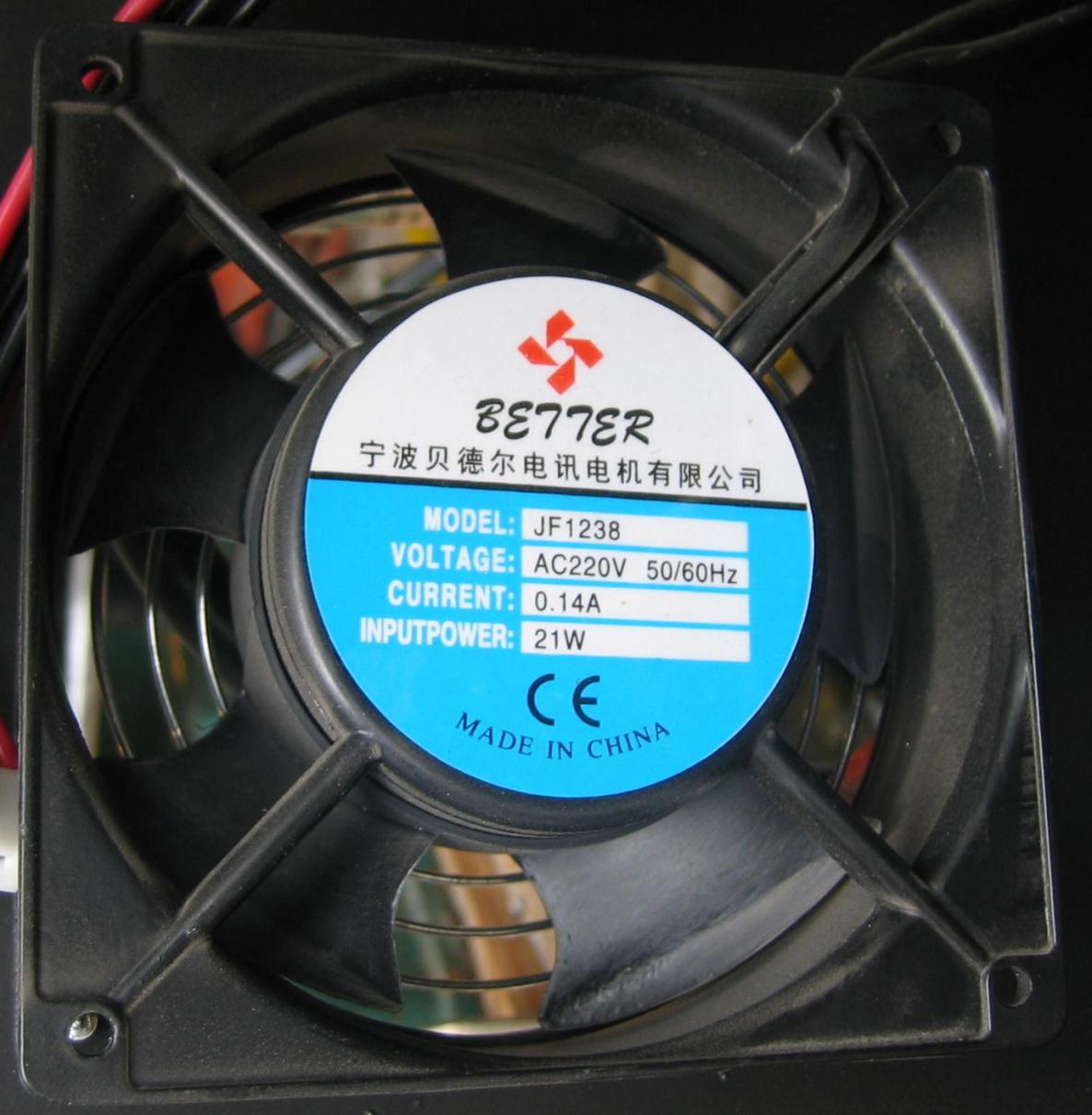

    If you wanted to revert the cooling fans back to the original "internal" design, I found a photo I took showing the make and model numbers of the fans of my Super200P that might be useful for ya:

    Those are the exact fans that are in my 160. They aren't really special, just easy little 220v fans with a standard frame size. My external fans are actually mounted with the same bolt holes in the case as the original fans. But really they work a lot better, and since they were higher quality fans, they run a lot quieter, too. My welder used to over-heat and shut off when i was doing full-power aluminum welding, but with the new fans it hasn't been an issue. The temperatures inside the case (especially around the FETs) have dropped dramatically.

    Not likely that the LED display itself is the problem. More likely is the chip that drives it, if you lost all segments at once. A lot depends on the design. It may be that the display and driver are housed on a board that can be easily swapped out.
    I'm not actually worried about the digital display. It's a 'cute' feature on these models, as all it does it display the current welding/plasma cutting amps. The only time i used it was to figure out which knob on the face controlled the plasma cutters power output. Other than that, your welding hood is down and the display is unreadable anytime that it isn't reading "000".
    I'm thinking the controller board died on it.
    What i'm worried about is if the controller board for the display is part of the same board that controls something else important that might be about to go out.

    Definitely the controller circuit on the led display... Since it magically started working again today. If the display itself were the problem it would die and stay dead. :/

    Sounds more like a loose connection or dirty plug. Once the magic smoke leaves a chip it doesn't often return.
    Also you could look for cracked/cold solder joints, but my money is on the connectors. A little oxide cleaner can work wonders on things in a dirty shop environment.
    Sounds like a loose connector here too. One a IC chips that might need a little push. Corrosion is a bad thing, I know for me it is. Also, grinding and spatter, dust. All flying around and the large cooling fan will pull it inside the machine is any floats in front of it. If you pop the cover to check the plugs, see if it might need a little compressed air too.
