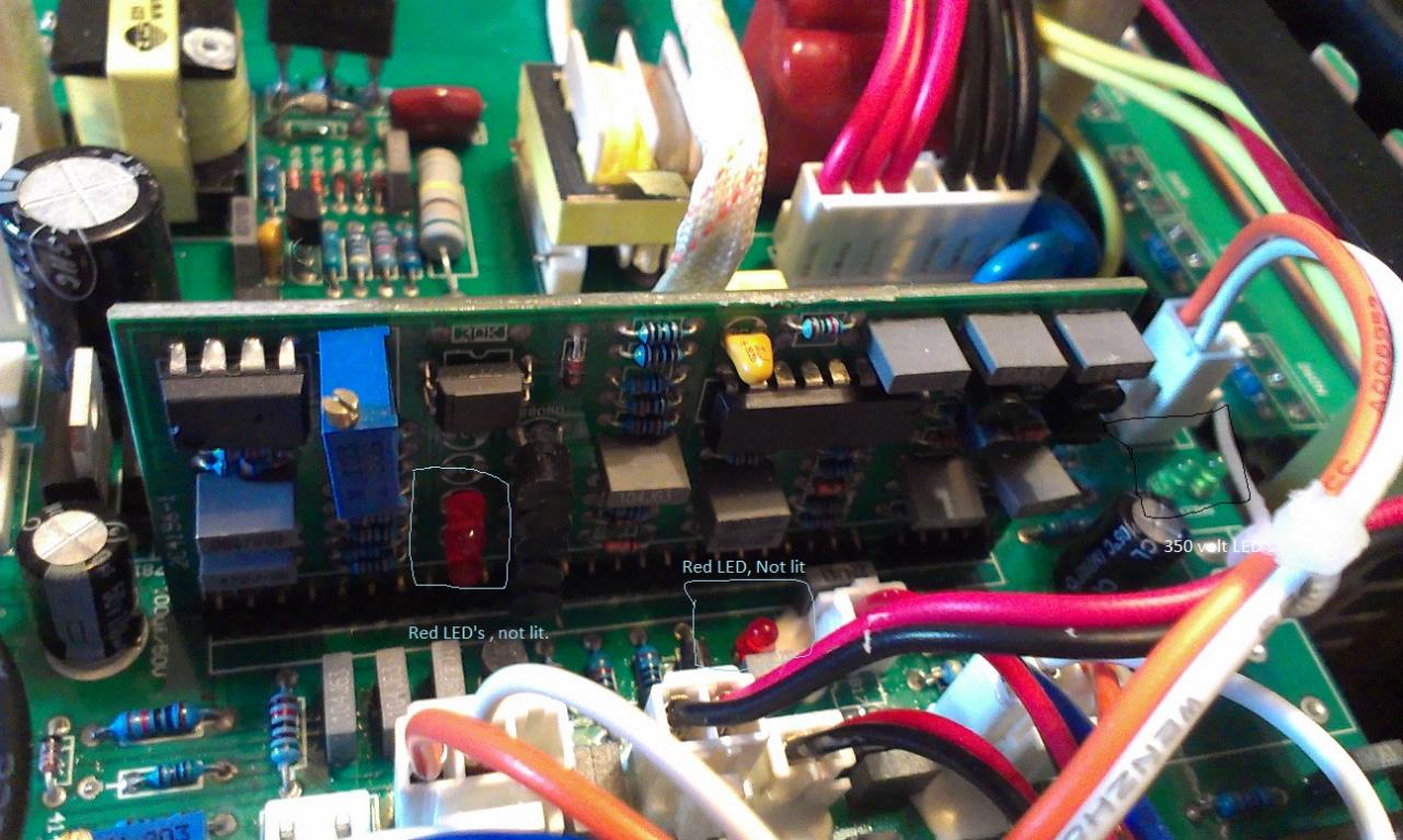

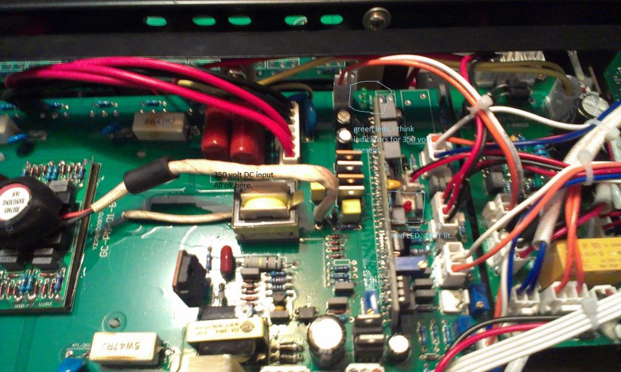

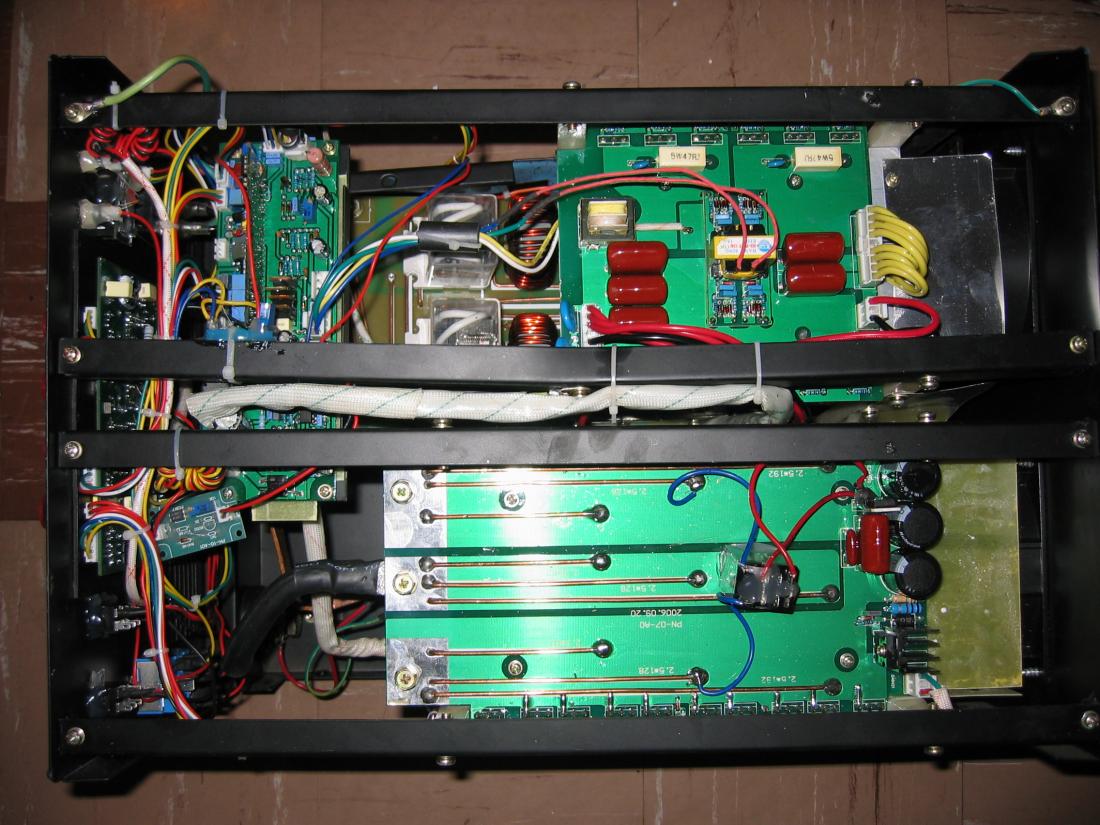

ID:	9081Hello all, new to this forum.
    I have a Rotenbach brand Super 200p and have been very happy with it until now.
    I was going to do some MMA welding and discovered that i had no arc!
    I double checked all cables, ground but they were good.
    Then i tried plasma and TIG ,both AC and DC, same result, no spark at all.
    The display reads "000" no matter how i turn the "amp knob".
    The "over current light" does Not come on
    I hear relays click as i switch from MMA to TIG, sounds normal
    I have measured all power transistors and diodes and i cannot find any shorted component.
    On the "top left" circuit board i measure 320 volt DC in from the rectifiers below but there is 0 volt out from this board.
    I beleive the "front board" (the one with the potentionmeters) send controll voltages to the "top left" board to regulate current and so on but i cannot find any regulated voltage when i turn the "amp knob" and measure with a multimeter
    There are 2 green LED's on the "top left" power board, they are lit up, (i think they indicate the 320 volt DC)
    There are 3 red LED's on this board (and an small adjacent board thats soldered to this top board) none of these LED's are lit up.
    there is a board "in the center at the bottom of the machine" this board gets 4 volatages from the transformer also down at the bottom.
    the transformer puts out 4 20 volts in 8 cables that feed this board, there are 3 15volt voltage stabilisers on this board, they all have 15 volt out, but there are 4 connectors leaving this board, 2 wires each (red and black) leeding up to the different power transistor boards, there is only 4.5 volts at these connectors.
    I am a trained electronics repairman (or used to be, i dont work with it anymore) so i should be able to repair this if i only had a schematic or got some tips on what to check next.
    I will ofcourse pay for a schematic if anyone has it.
    So anyone who had this problem or Everlast support, please post some info about it
    Regards /Janne Strom

    Hi Janne - if you didn't find any shorts in your diodes, then for better or worse, you have a different problem than what happened with my machine (a 2007 Everlast Super200P.) Also comparing pictures of my machine to your Rotenbach, it appears there are some substantial differences. For example, your "upper left" circuit board for is larger than mine (with a lot more going on with it - See attached picture for a top view of my machine, FYI.)

    Question: in TIG or plasma mode, when you trigger the arc, is the gas solenoid working?

    Janne, I studied the schematics a little, and I have a suggestion for troubleshooting your problem. Referring to the picture below of the front panel control board, the J1-2 pin is supposed to have a positive voltage (in relation to its neighboring ground pin, J1-1) whenever welding current is requested. In stick mode, this should be a on all the time, and a constant voltage, less than 12 volts. This voltage should scale linearly with the requested welding current (e.g., increasing the peak current knob should cause a corresponding increase in voltage at J1.)
    Maybe you could verify whether there is an appropriate voltage there in yours? Just look for any signal that is significantly larger than 0V. If there is no voltage getting to J1-2, I think that we should be able to trace the problem backwards using the helpful schematic of this board. (You do have this board with the nine knobs, correct?)
    PS - I have a feeling that since your digital display is always reading "0", that you won't be seeing any voltage at J1, but it's just a hunch.
