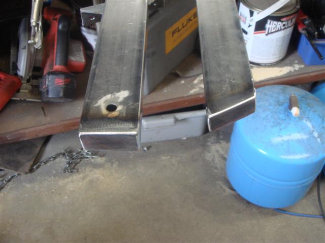

    I haven't purchased any new tubing for this. I got extremely busy at work and have not had the time to complete this project. But I have learned a few things from this project and a few other projects I've welded at work.
    One thing that I didn't do here but should have is cut the ends of the tube at a 45 degree angle and welded them together so there is not a awkward open end. I learned this doing some 1" steel frame for some stuff at work!!!

    Quote Originally Posted by sw2x View Post
    Looking to finish this project possibly next week.

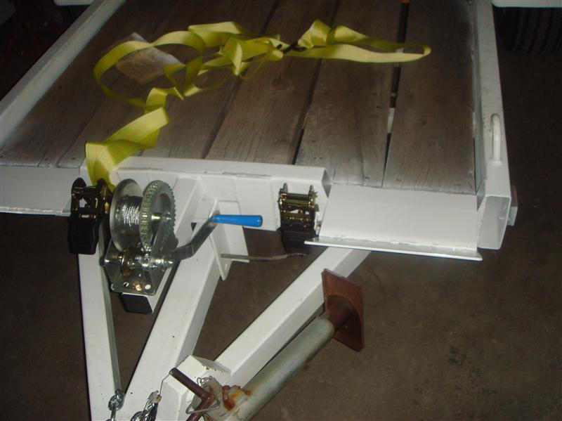

    For joints you forgot to miter, you can get some square plastic plugs that snap in the end of the tubing. It's a quick and easy way to finish off things, and looks nice. Another option is to weld flat caps to the ends, and grind smooth. I used the plastic cap for the tube that the hand winch mounts on, and welded caps for another project.
