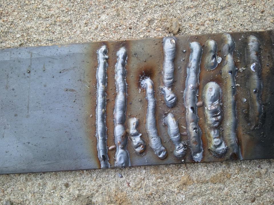

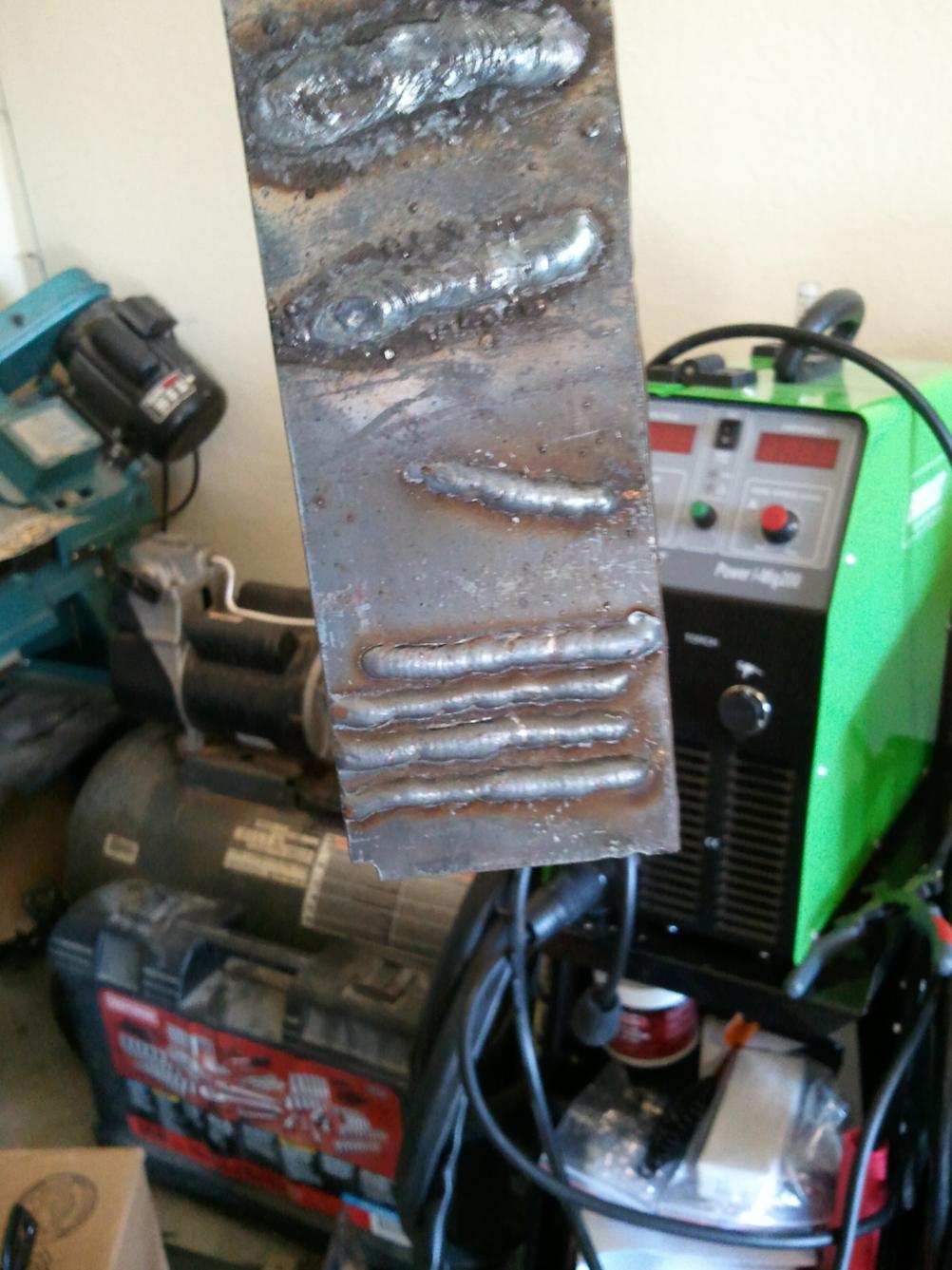

    I've just got my Everlast IMig 200 wired and did my first welds. My only welding experience has been running one bead about 8 years ago messing around with the welder at work. The top two welds are my first two stick welds ever. Not too pretty but I thought striking an arc was very easy with the 6013 3/32 rods on this machine. I've read how hard it is to strike an arc and that I would get the rods stuck a lot when learning but so far I haven't had a 3/32 rod stick yet. The 1/8 6011's were a little more difficult for me. The bottom welds were my first attempts at mig. The top one was the first and then it progressed from the bottom up. I think they are pretty cold welds but all I was really going for at this point was a straight line as I figure this stuff out. Any critiques are welcome.

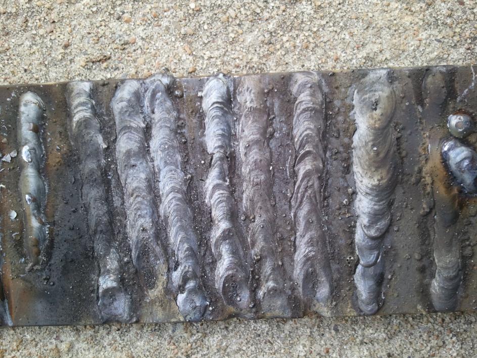

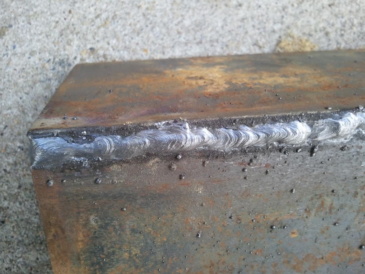

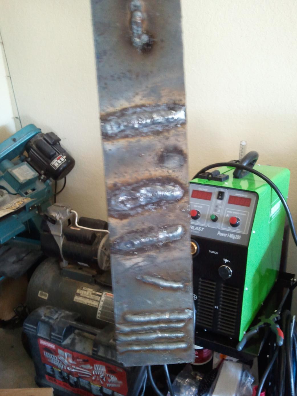

    Here are pics from day two welding. Pic 1 is more mig work, pic 2 is more stick, and pic 3 is stick joining some 3/16" plate. Again, I really need to work on getting more penetration with my mig.

    There are a bunch of online MIG calculators that will give you some basic starting points.
    HERE is a page with most of the formulas and conversions on it.
    For everything you ever wanted to know about MIG, see this Lincoln document.
    The only issue is that the readout for wire speed on the iMIG isn't in inches per minute, so you might need to learn the scale. Just hit the trigger for 6 seconds and measure how much wire comes out, Then multiply by 10 for your true inches per minute. Every MIG welder is a little different and even two of the same model can have slight differences in wire speed settings. The thing to learn is the proper sound. Set the voltage for the metal you are welding then turn up the wire speed until you get that sizzling sound. If you can, the fastest way to figure that out is to be in a position where you can weld a test plate, while you have a hand on the wire speed knob.

    You are correct that they do look cold. It also looks like you make pretty tight movement which is something I did at first also. I would bet more heat and maybe moving a little faster or in a little bigger strides would make it pretty nice.
    After looking over the info from Lincoln that Rambozo linked to I see that I was way off on my Voltage and wire speed settings. I'll be in the shop welding on thursday so I'll try the higher settings and see how it goes. Thanks for all the tips.
    I got it cranked up to 22v today with a lot more wire speed and I was getting full penetration but man did everything speed up. It took some time getting used to moving faster and was harder to keep a straight line and not blow through. I'm guessing that i'm now a little hot but would rather be on this end than the cold side. All I can say is that at the higher speeds, you can burn through a small roll of wire in a hurry. Can anyone with a Imig 200 let me know what settings you would use for 1/8" steel with .030 wire. I was at 22V and the speed was around 3/4's of the way up. I know all the welders will be a little different but would be good to get close. I was having some issues with erratic arc starts and got some burn back a few times on time bad enough to foul the tip. I'm wondering if I need to check my tensions on the rollers and wheel to see if that's where my problems are. I was reading that burn back could be caused by to slow of wire speed but the speed seems really fast. Almost too fast?
    If you are using 75/25 gas you could back down the voltage just a touch. That would slow things down just a little until you are more comfortable with it. For straight CO2 I would stay where you are. Unless you measure your wire speed, there is no real way to compare settings. I find that a line's width adjustment on the dial is often enough to go from bad to good. Doesn't that model have a burn back timer control, too?
    As Rambozo said, you could count the wire to get an estimated speed. I know on my MTS unit I had to dial down the burn back some when I got it. Could be a possible place for you to check but if you are burning through the metal then you would probably be ok to slow things down a little all around. This would still push enough heat in.
    As far as checking the tension on your rollers what I do is I put a piece of wood down and aim the torch at it and pull the trigger … if there is enough tension the wire won’t stop it will bend … then on the other hand you don’t want the tension do tight that it cuts little groves in the wire because it’s pinching too hard. On the point of fouling the tip … I sometimes get some of that so I periodically spray a little non-stick on it.
    Powertig 200DX
    Lincoln 180c
    Hobart Handler 125
    and a bunch of other tools
    I got it dialed in, thanks to all. I ended up at 21.5V and 270 ipm and it was perfect for the 1/8". I got my Audio Visual Cabinet built and I'll post some photos over in the projects forum. I'm not sure if this has a burn back control if it does, where would it be?
